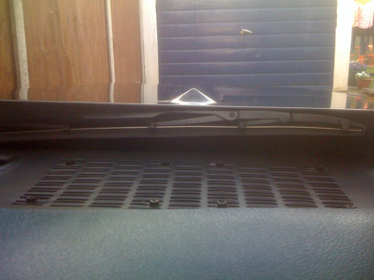

hitting pic 1

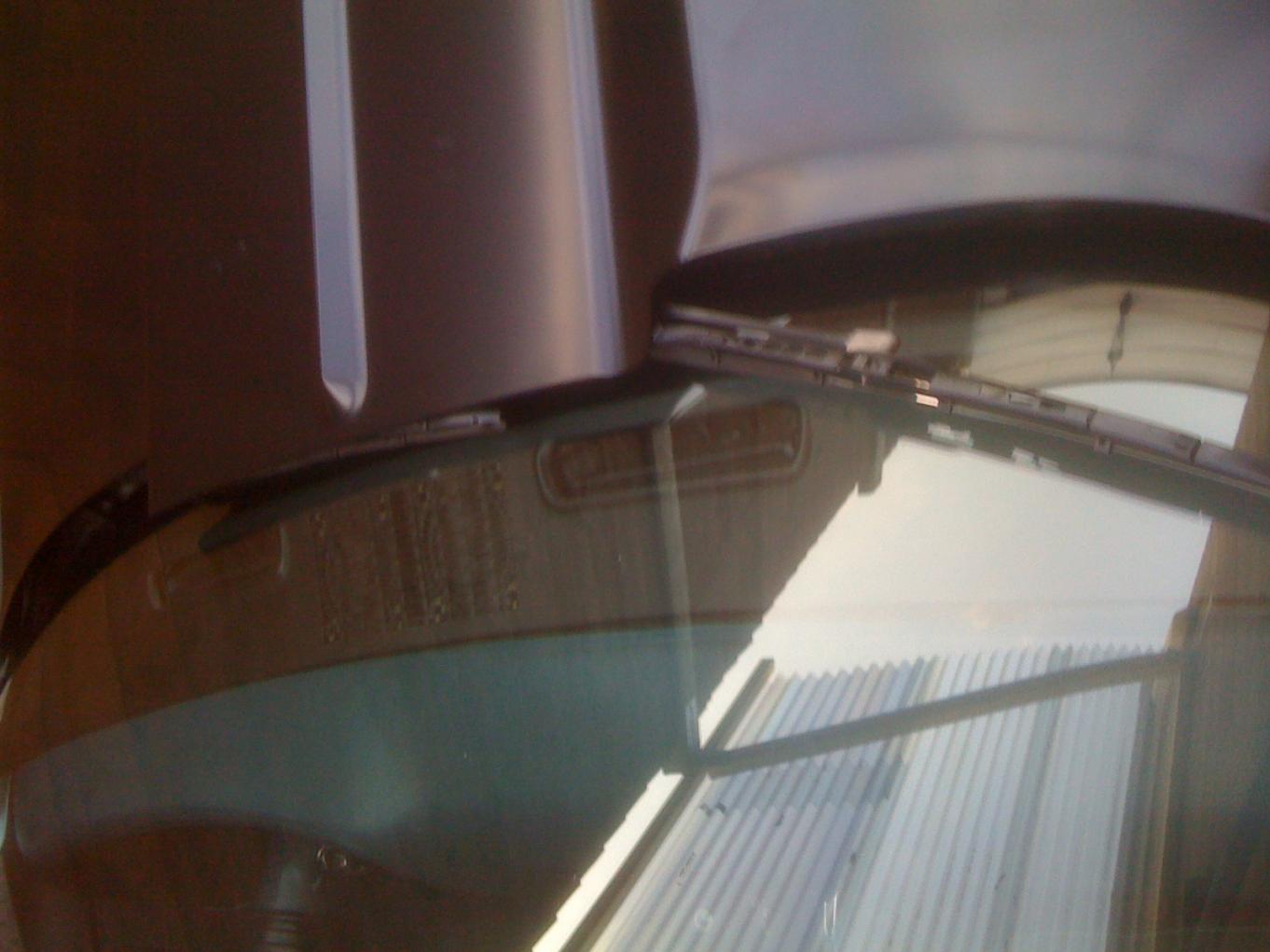

hitting pic 2

Hi,
Just uploaded 3 more pictures of the wipers trying to operate, but hitting the hood. Please let me know what you think. I think i may have to modify the hood, as i dont think any wipers would be able to clear it.
Thanks from Luke

I don't think you could modify the hood to make it clear the wipers and not have the hood be out of alignment with the fenders. That type of blade is much taller than stock, so you need stock blades to get low enough.
Old Mar 23, 2011 | 11:35 PM
  #29
I would do my best to find a stock set of wipers if I were you. Then just replace the blades. I have read about this a few times. I knew that was your problem, it happens with the stock hood too.

made afew phone calls today, but not hered anything back yet. If they cant get them, i will call Rick's. I'm on his mailing list so they should send to the uk.
Fingers crossed this will sort the problem out, if not the wipers will look good anyway.
