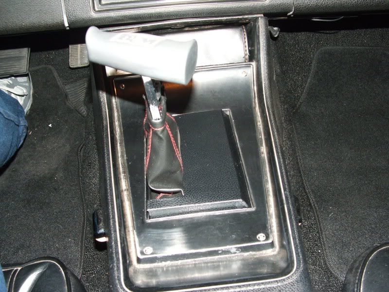

Got bored with the nasty weather, so decided to go back and redo the console filler panel I built previously. I didn't need all the height that the round hump gave, so I tore it out and built a flat raised insert to replace it. Started out by making a template out of cardboard and installing it first.
Once I had the cardboard template in I made adjustments and taped on extra pieces where I needed them to get it right. After that I removed it and laid it out flat on my donor aluminum sheet. Traced the metal and cut it with my tin snips. Then I bent it to match the pattern in my wood vise, and drilled the mounting holes. Covered it with self adhesive black vinyl and checked the fit. I cut down the left filler piece from the first design and recovered it as it was worth saving.
After checking the fit and fine tuning it I reinstalled the nuts on the back, and put it back in the car to final test the travel and clearances. All worked well, so screwed it back in place and was done!

Clean and neat. Nice touch.

Thanks! I get bored when it's raining.

One of these days, I'm gonna figure out ALL the uses for my tools. I just hope it's soon, cus' you're beating me to all the good ideas I never had. Nice Job!
