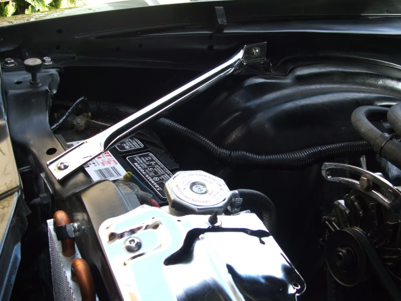

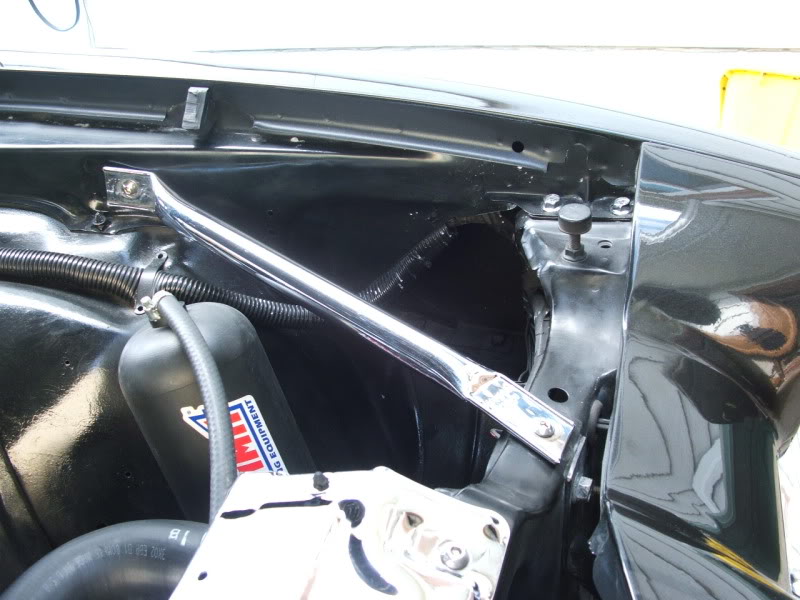

Helped my neighbor put a swaybar in his Chevy truck this morning, then decided I'd put off making braces for my front spoiler long enough. Searched the garage and found some old aluminum tent poles that looked pretty nice. Polished aluminum braces would be way tricker than just black tubing, and lighter too!
Measured up the hole distance and cut the braces about 9" long. Then I flattened the ends in the vise and bent them to about 20 degrees. Took them outside and held them in place so I could use a felt pen to mark the holes. Drilled the 1/4" holes and bolted them in with fender washers to spread the load on the plastic spoiler. Less than an hour's work!
Braces:
Installed in the car:

Cool, very creative you are huh

Good stuff! Love the art of using what you have.

Thanks guys! My friends say I've still got my first buck, just because I'd rather spend time than money on the car when I can! Actually it's part thrifty, and part "wonder if I could build those?". I've been known to spend hours on a $10 item, just because I wanted to see if I could do it myself.
I turned my front and rear swaybar bushings on my lathe from some old teflon I found at work, just to see if it could be done. Tossed a few before I got it right, but darn if I didn't finally get them! Just spun them round, milled one side flat on the milling machine, then turned the correct hole in the center and cut a split to allow installation!
Afterall, isn't that what hotrodding is really about?
