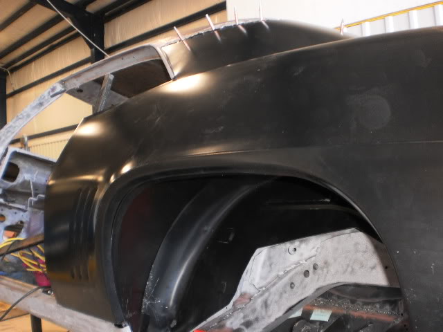

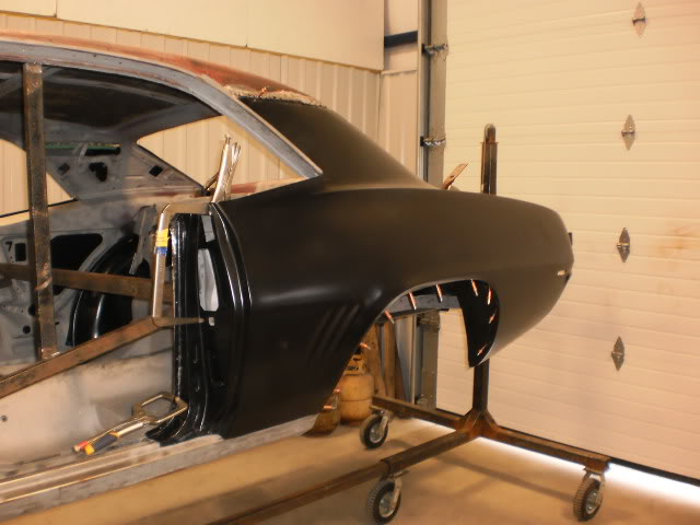

I test fitted the drivers side quarter panel. It fit almost perfect. I didn’t want to take it off, it fit so well, so I thought I would just slip the wheel well in.
Yeah, after a couple of hours of hammering and swearing I decided to leave it for next weekend. I’ll take the quarter off and do it the right way
and fit the wells then re install the quarter

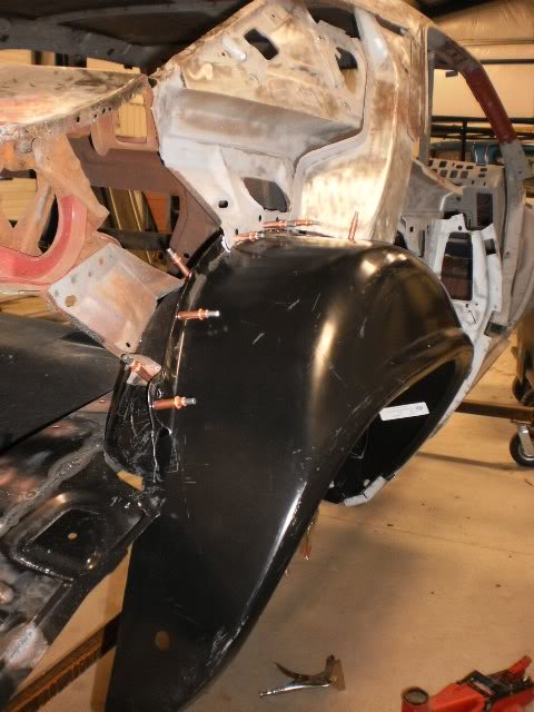

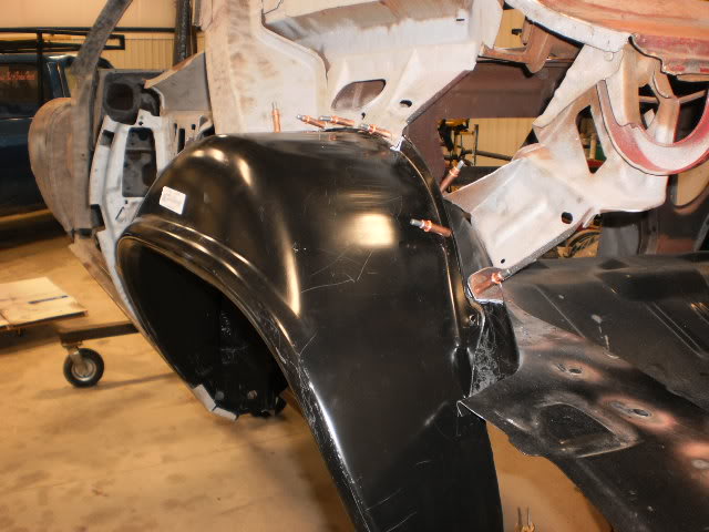

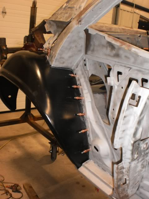

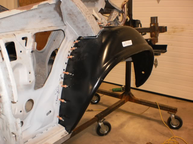

I got the wheel wells roughed in today.

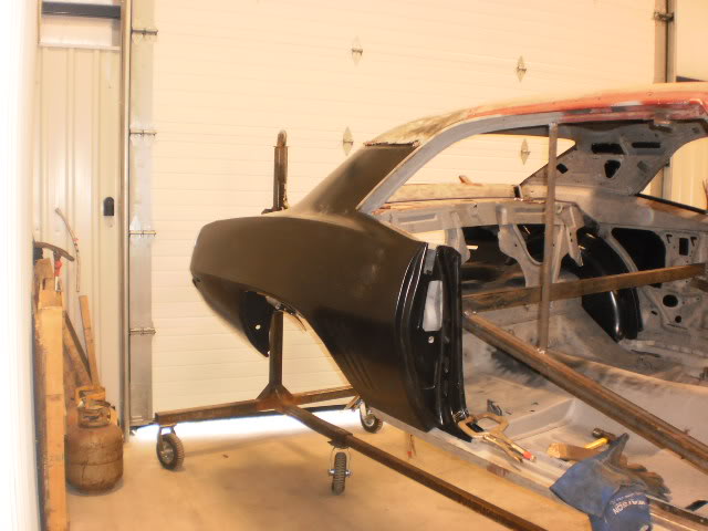

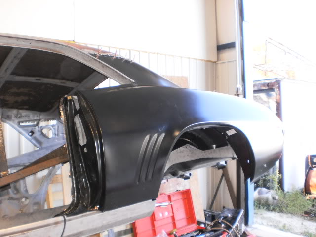

I got the quarter panel and wheel well to play nice together

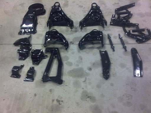

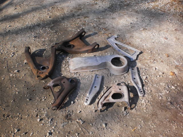

Did some sandblasting prep for powdercoat

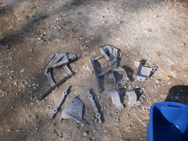

After powdercoat
