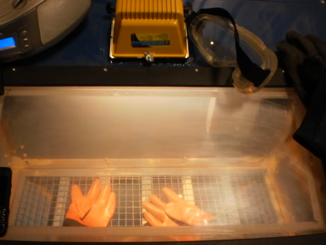

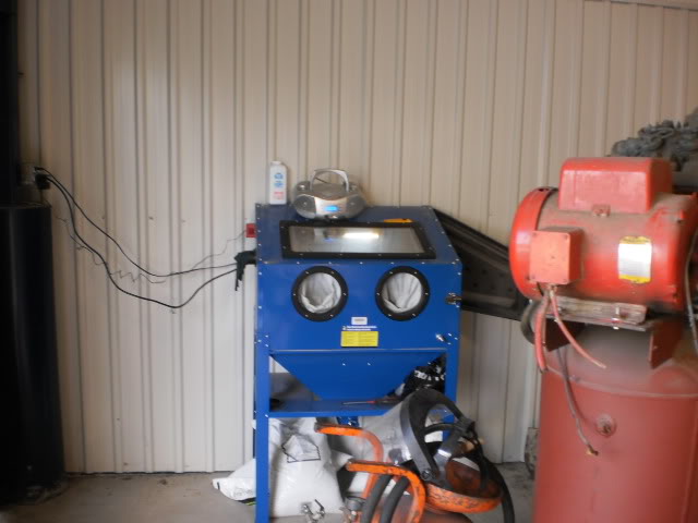

I had to modify my sandblaster a little. I put this 500W light in the top so I can see what I’m sandblasting. The light that came with it was a joke
Size:  41.2 KBName:  Newlight.jpg

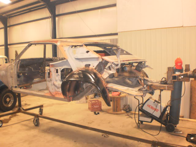

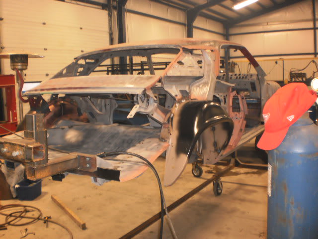

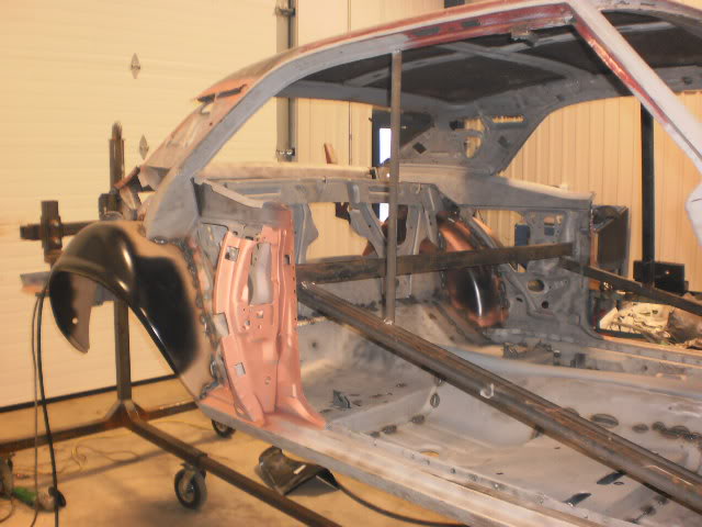

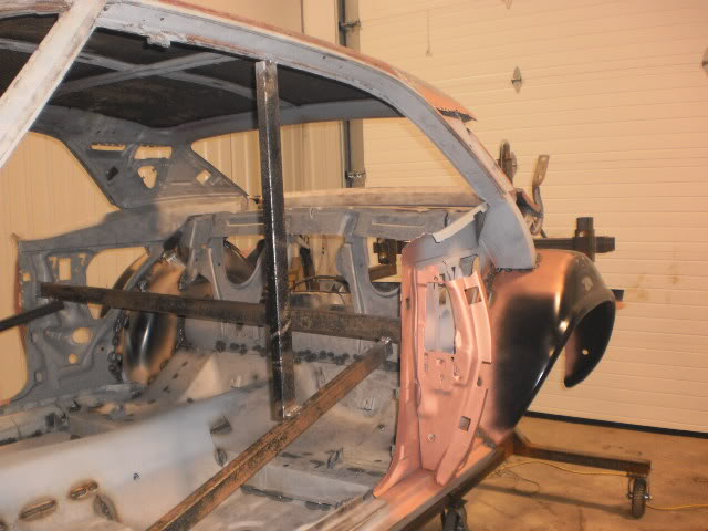

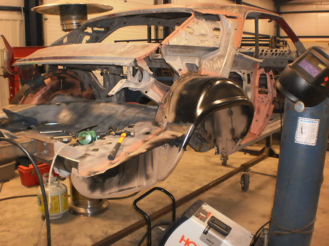

I got the wheel wells welded into placed. Drivers side front and back
Size:  50.3 KBName:  wheelwelldirverback.jpg
Passengers side front and back
Size:  52.4 KBName:  wheelwellpassengerback.jpg

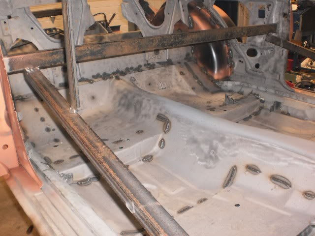

I reinforced a lot of the factory spot welds with some stitches.

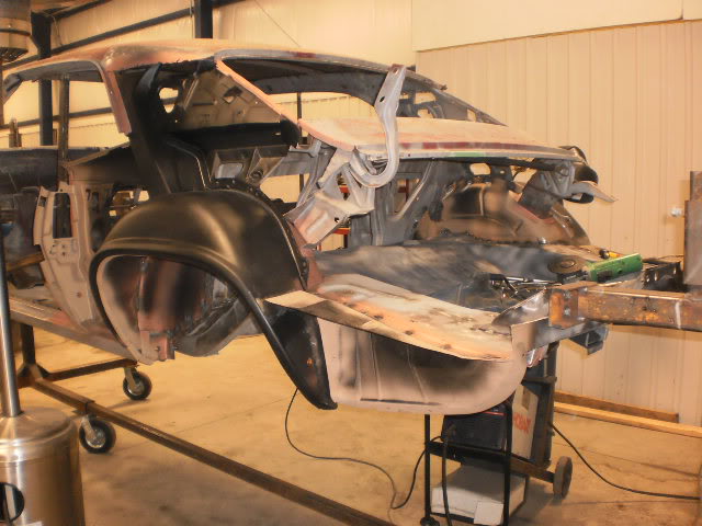

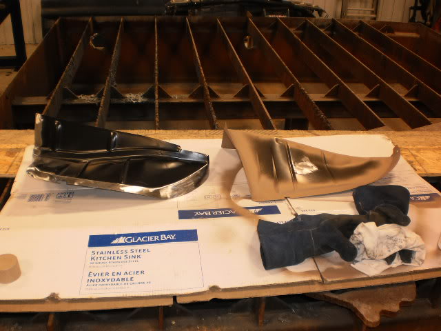

I prepped both Trunk Drop Offs
Here is the Driver side Trunk Drop Off installed
Here is the Passenger side Trunk Drop Off installed

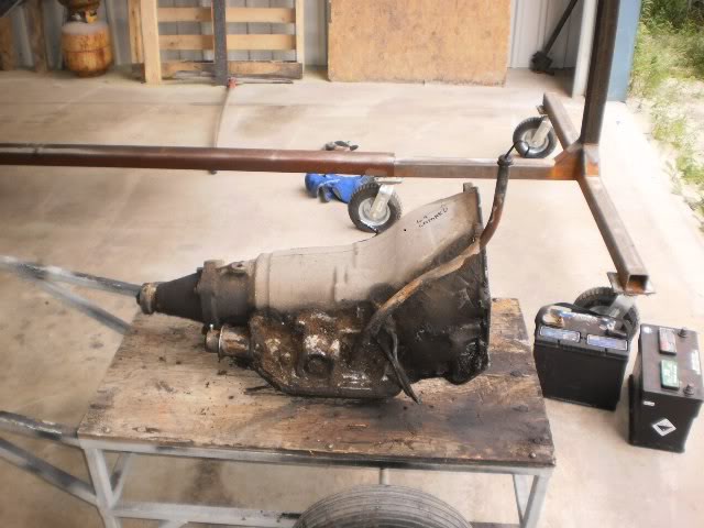

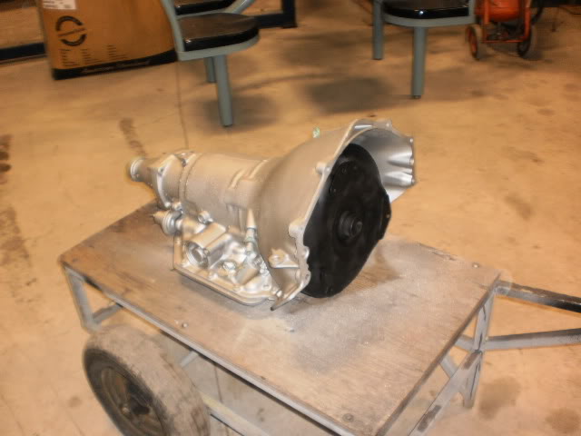

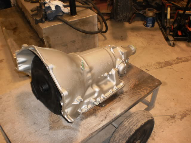

I didn’t have time to start on the ¼ panels so I cleaned up the transmission and threw a coat of aluminum paint on it.
I also painted the torque converter flat black because it had a lot of surface rust on it. I put it away until the body is completed
Before
After
Size:  38.1 KBName:  Transmissionafter-1.jpg

Looks nice. You might want to put a coat or two of clear on the trans. I've used that aluminum paint before, and it wasn't very durable against preventing solvents or oils from attacking it.
Old Jan 9, 2012 | 03:24 PM
  #140
ToddB's Avatar
Joined: Jul 2010
Posts: 135
Thanks Camaro69. Point taken. Ill do that with the final coat in the spring.
