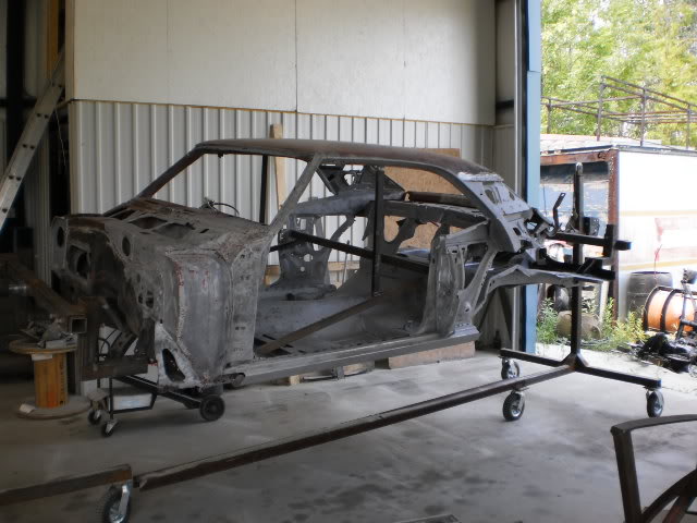

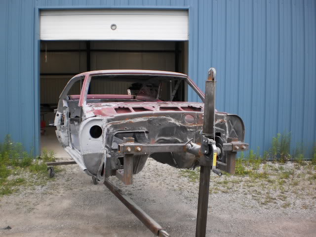

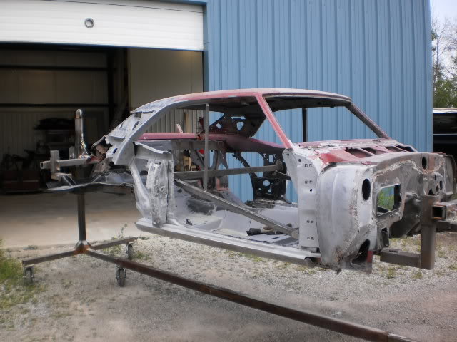

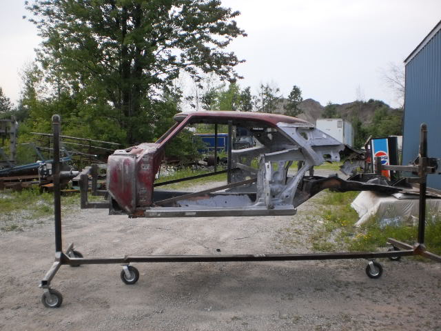

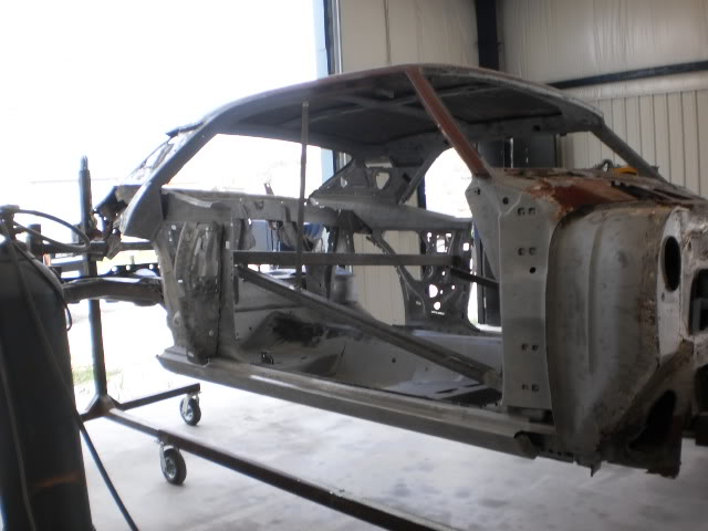

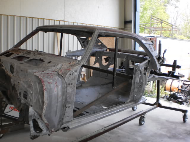

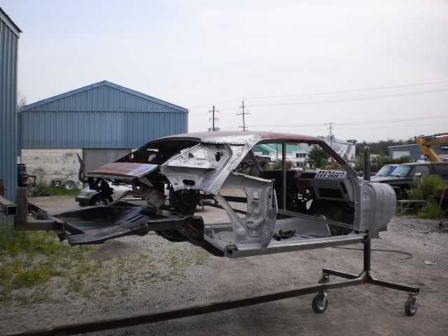

I thought that I might as well get the sand blasting out of the way before I get too far into fitting the quarter panels. I pulled the car outside this weekend and blasted it over 2 days. I spent about 12 hours and used 25 bags of sand. Between refilling the sand blaster and the nozzle getting clogged with staples I was all in by 2pm today. Name:  P7020072.jpg

I still have a day or 2 of sandblasting left. I’m pretty happy with it so far

The worst thing about sandblasting is that from now on, you will keep finding sand. I had mine on the rotisserie, and I still kept getting it when I rotated it around. The last was when I had the bottom soda blasted. When I washed the floor to spray on lizard skin, I was washing away white powder.

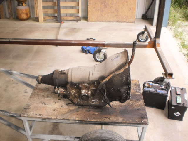

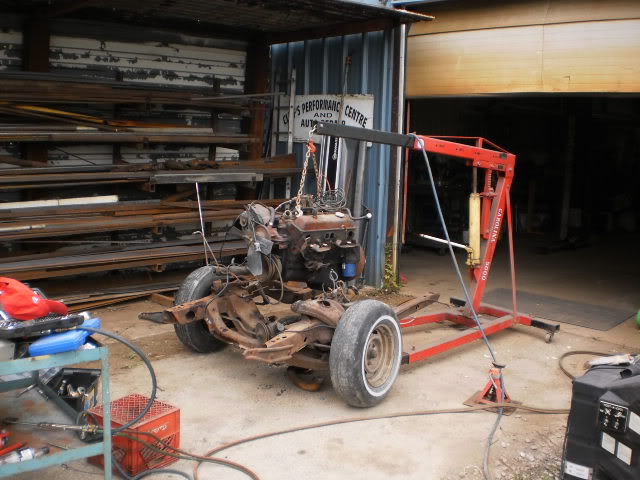

I decided to start to get the frame ready to sand blast while it was nice out. I really want to get ALL this blasting done cause it’s a real pain to do.
So I pulled out the transmission and engine. I’ll clean them up next weekend and ship them out to be rebuilt.

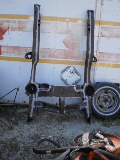

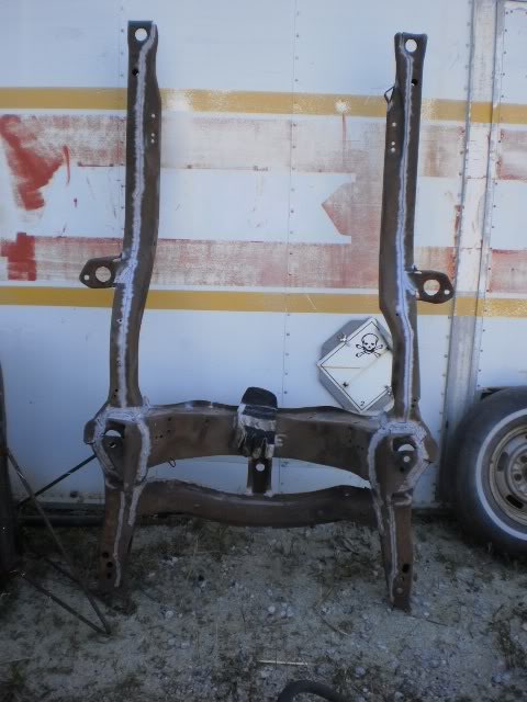

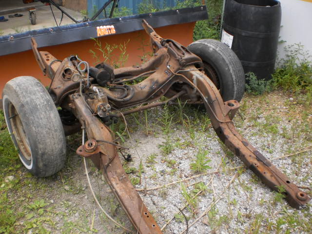

I sent the transmission into the shop today for a shift kit and tune up. I also got the sub frame all stripped down. I sandblasted all the welds and seams on the sub frame.
I’m going to redo all the welds and fully seam weld the frame. That should stiffen it up nicely
