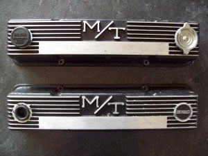

Have the engine pulled from my 68 (327) replacing seals, repainting, nothing major, but I need advice on refinishing the valve covers. I have aluminum covers similar to the picture. Since they are aluminum, I don't want to sandblast them. What is the best way to strip them? Also, am I able to powder coat them? I would like to cover them with wrinkle black

Maybe media and or chemical stripping? Use sand paper and a lot of elbow grease are others

Since you're going to do them in wrinkle black I'd just take them in to be bead blasted.

I have a blasting cabinet, use it for most of my other parts. I was concerned that it would dull the aluminum finish. My plan is to powder coat it wrinkle black, then sand the raised parts back to bare.

Then clean out the sand and put some other media in instead.
Old Jan 7, 2019 | 11:28 AM
Powder coat does not stick to polished surfaces well. It needs tooth to bit in. You will find that without any tooth (surface roughness) the power coat will shrink and split. You could use plastic media that will clean the surface only but then you should scuff it with scotch brite pad afterwards anyway. Walnut shells would work also.
Another tip on powder coating is to go a head and heat the valve cover up before you power coat it. Let any oil or solvents cook out before you coat it. If you don't you can get gas trapped under the coating. Also if you can hang the valve cover upside down. If you let it the powder will build up in and around the fins and letters.

Thanks, I hadn't thought of that. I only have the blaster for hobby purposes, and have always used just the medium grit media. I will look into that.
