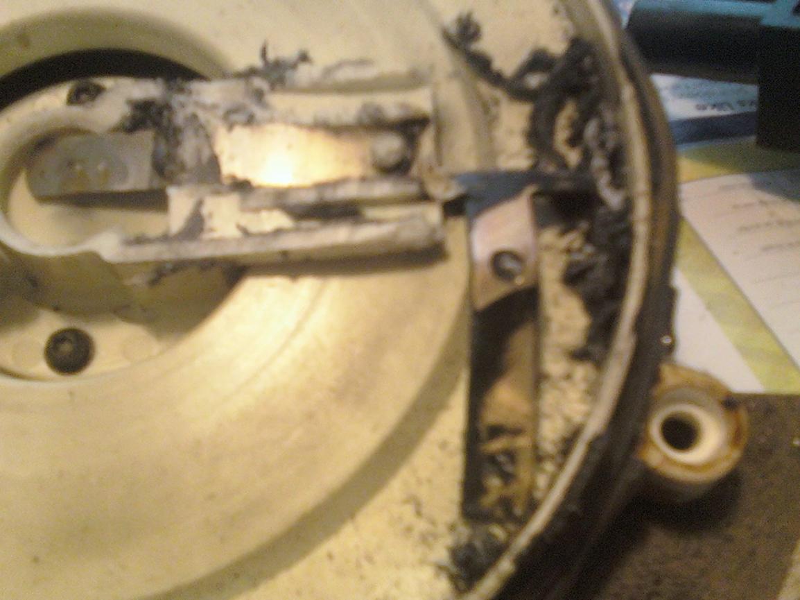

Update, I got the opti out and it had something rattling inside. I got it apart and this is what i found. I took it back and swapped it for a new cap. Hard to believe it was still running!!
Oh yeah, surprisingly it was dry as a bone inside

Old Aug 29, 2009 | 12:44 PM
Posts: 22,027
wow should not have been running alringht. she got u home, what a car.
Old Aug 29, 2009 | 12:52 PM
Blk93Z28's Avatar
Joined: Apr 2009
Posts: 66
Yeah I think its a keeper after that lol. Ran for 3 days like that. I was in shock! Might've fouled a couple of spark plugs tho.
