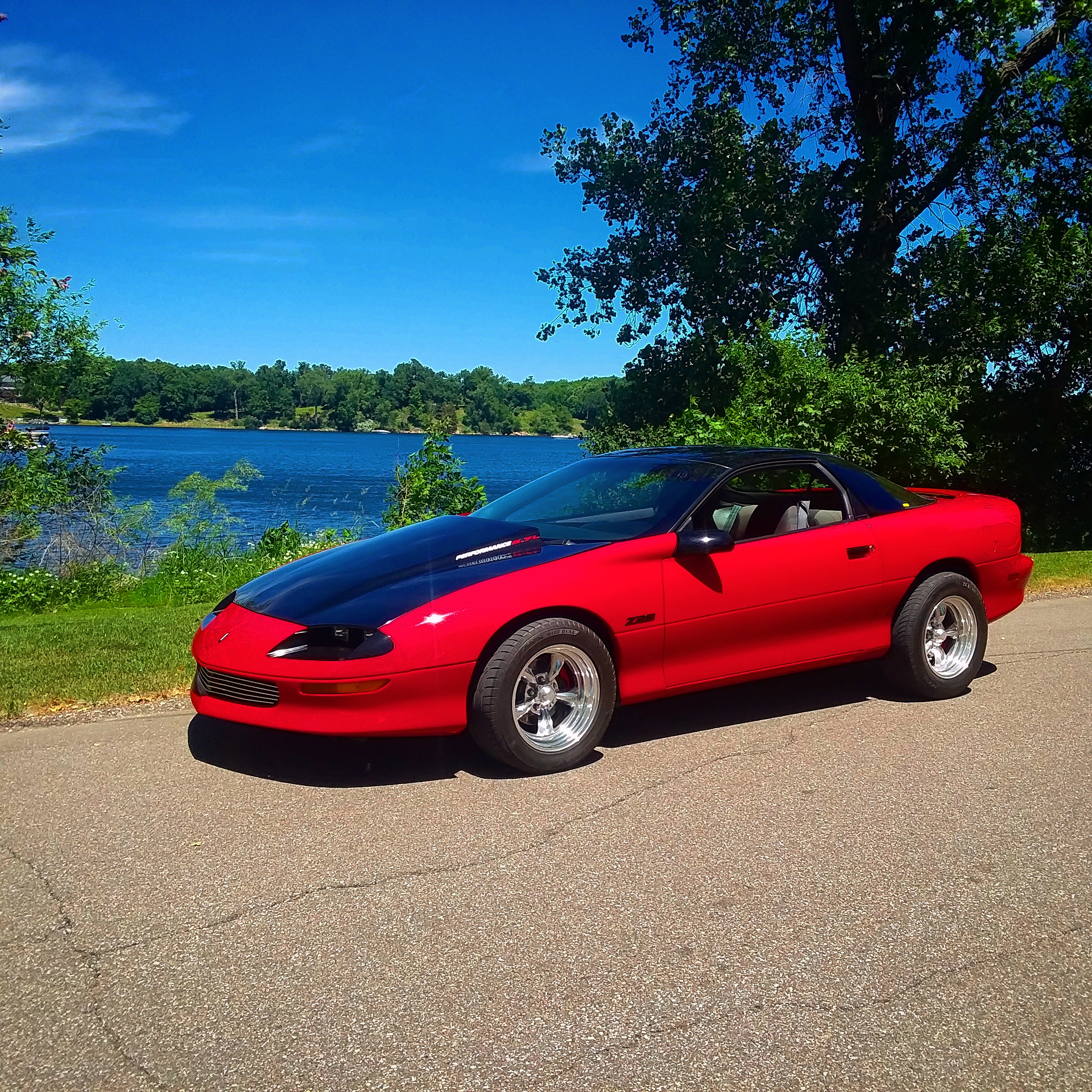

hey im currently having my 4l60e rebuilt and got a call from the shop wondering what size stall i wanted. car has 410 gears, he mentioned 1400 stall 1600 stall and 2100 stall. I do a fair amount of daily driving during summer and was curious about the pros/cons of the different stall sizes as well as street/strip performance with the 4.10s??? what are your preferences?? All help appreciated!
