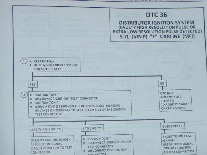

it is code dtc36.
Old Feb 24, 2011 | 07:59 PM
Posts: 22,027

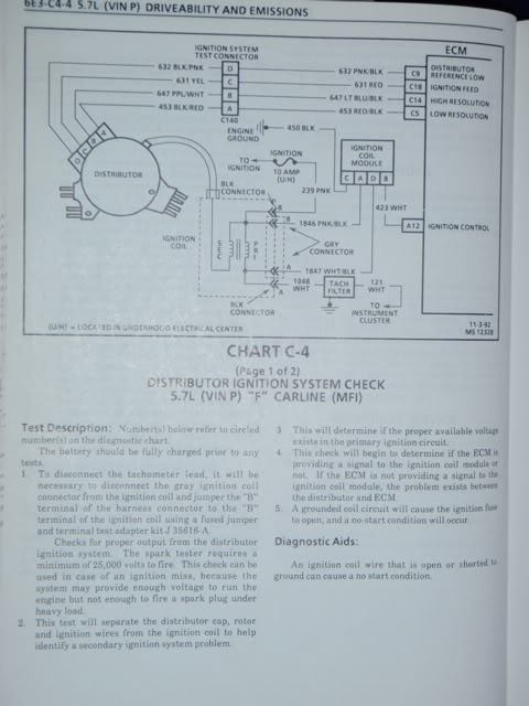

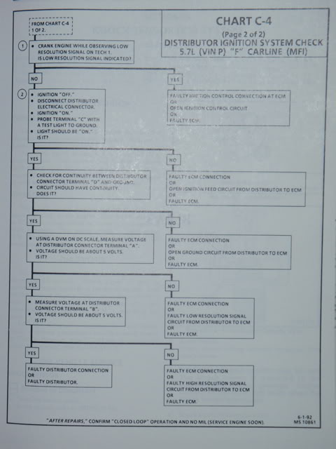

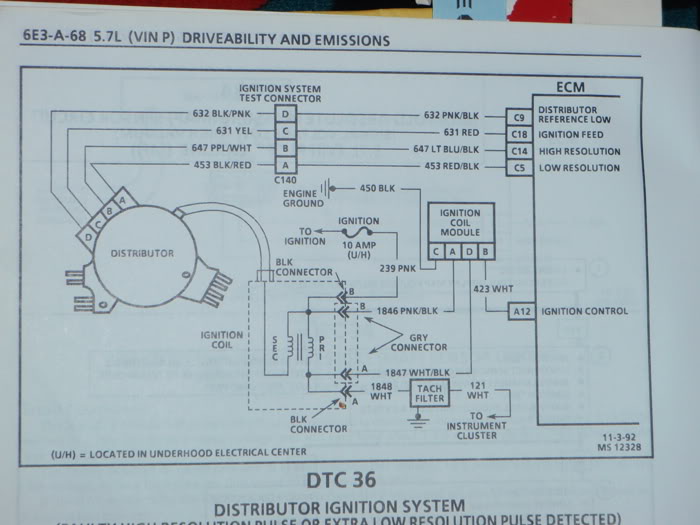

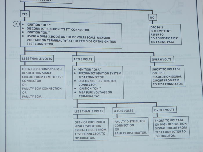

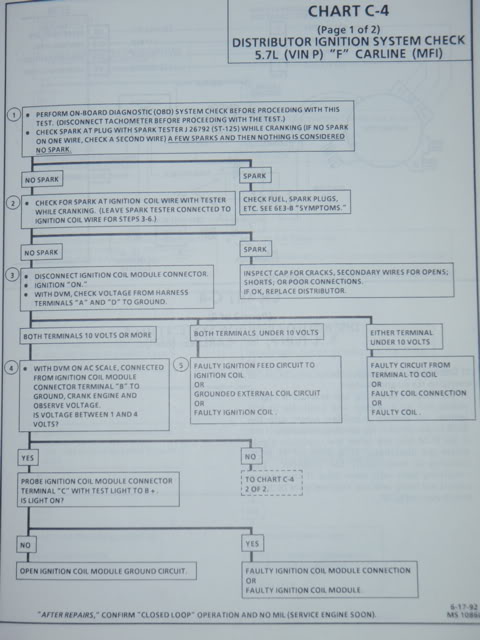

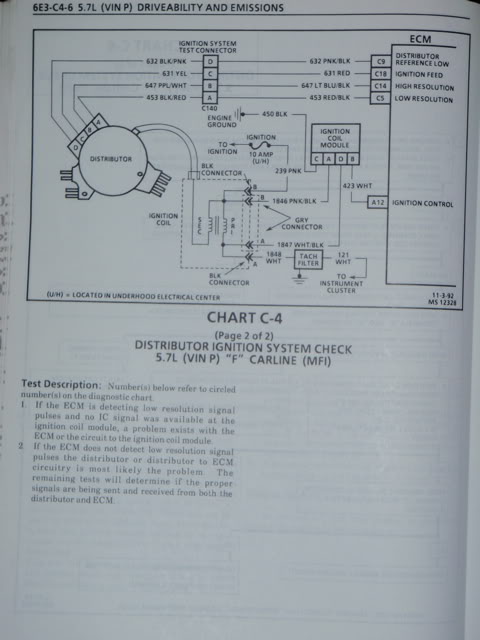

sure sounds like you got another bad opti and the shop doesnt want to face up. heres what ive got on it.
