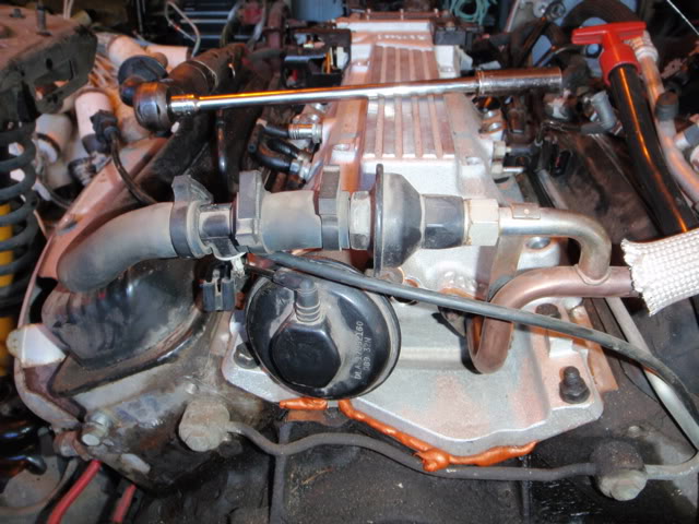

o no thanks man i got everthing just wish i had the 95 intake. i see where the egr valve goes but what is the other mini look alike agr hole that goes next to it. what is that called?
Old Jun 28, 2010 | 10:19 PM
Posts: 22,037
secondary air injection pipe on a 93, the exhaust air injection pipe from the 95 will fit. the connection is same as the 95.
heres what the 93 looks like.

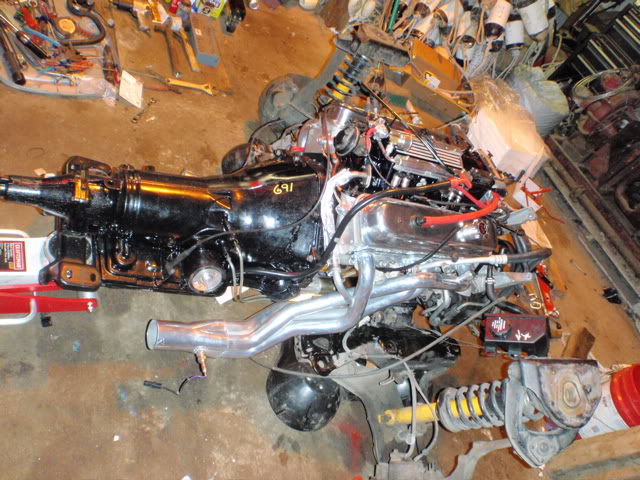

the 95 looks like this, you can see the pipe coming out of the header going to that hole.

o ok well im using the 93 intake so what do i need to buy for that cause i have the hooker headers and i dont think there is a hole on the headers for that. so should i just block it off?
Old Jun 29, 2010 | 08:01 AM
Posts: 22,037
if you have off road headers coming then you will need a block off plate.
Old Jun 29, 2010 | 08:32 PM
r6rider's Avatar
Joined: Jun 2009
Posts: 155
right on that works for me thanks!!!
