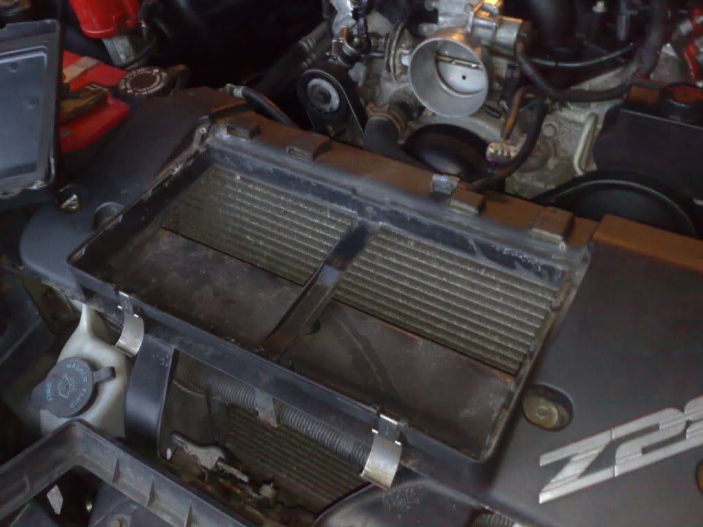

first remove all the intake lip and filter and the filter holder pictured here

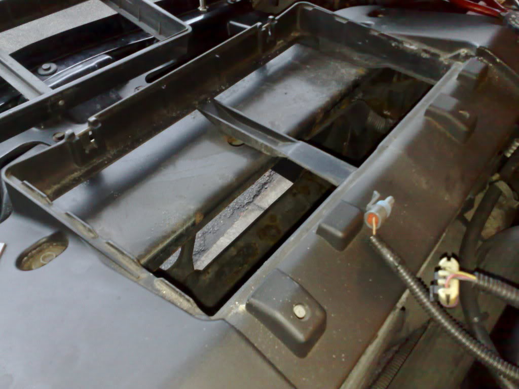

Now unbolt this radiator support bit and remove, you will notice on yours the bottom has plactic on it but I have trimmed my down so it has air flow to the under side of the car

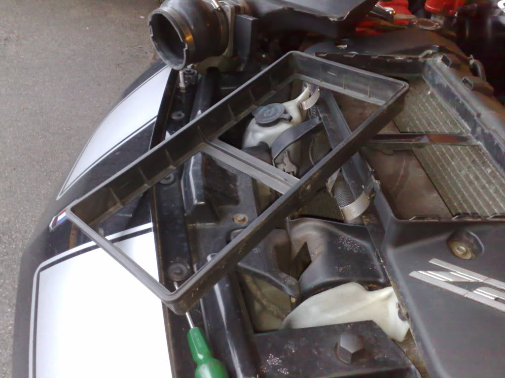

Here you can see straight down to the floor, you dont need the slp intake thingy as air will be directed up anyways by the scoop under the car for the radiator. My intake , throttle body and manifold are always cold after a drive and when logged the temps max at about 8*C in 30*C and up weather
