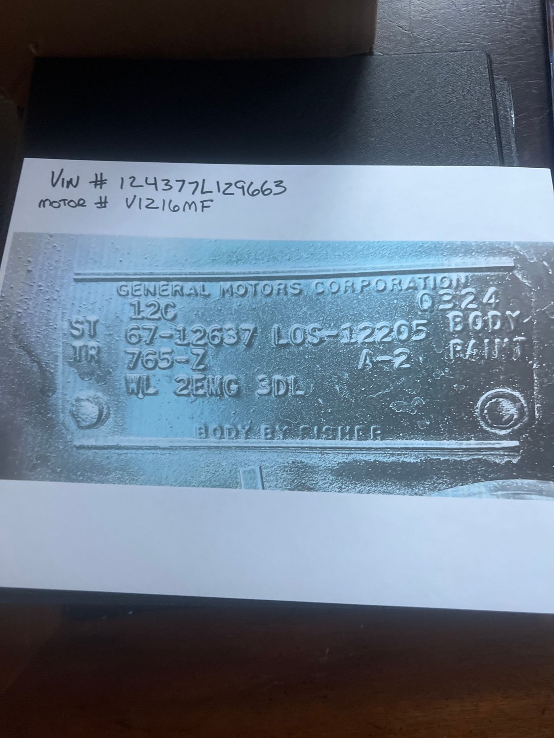

Augster's Avatar
Joined: May 2023
Default Matching numbers
Is this a matching numbers car TIA
Old May 11, 2023 | 09:42 PM
You should start a new thread,this one is over 10 years old.
