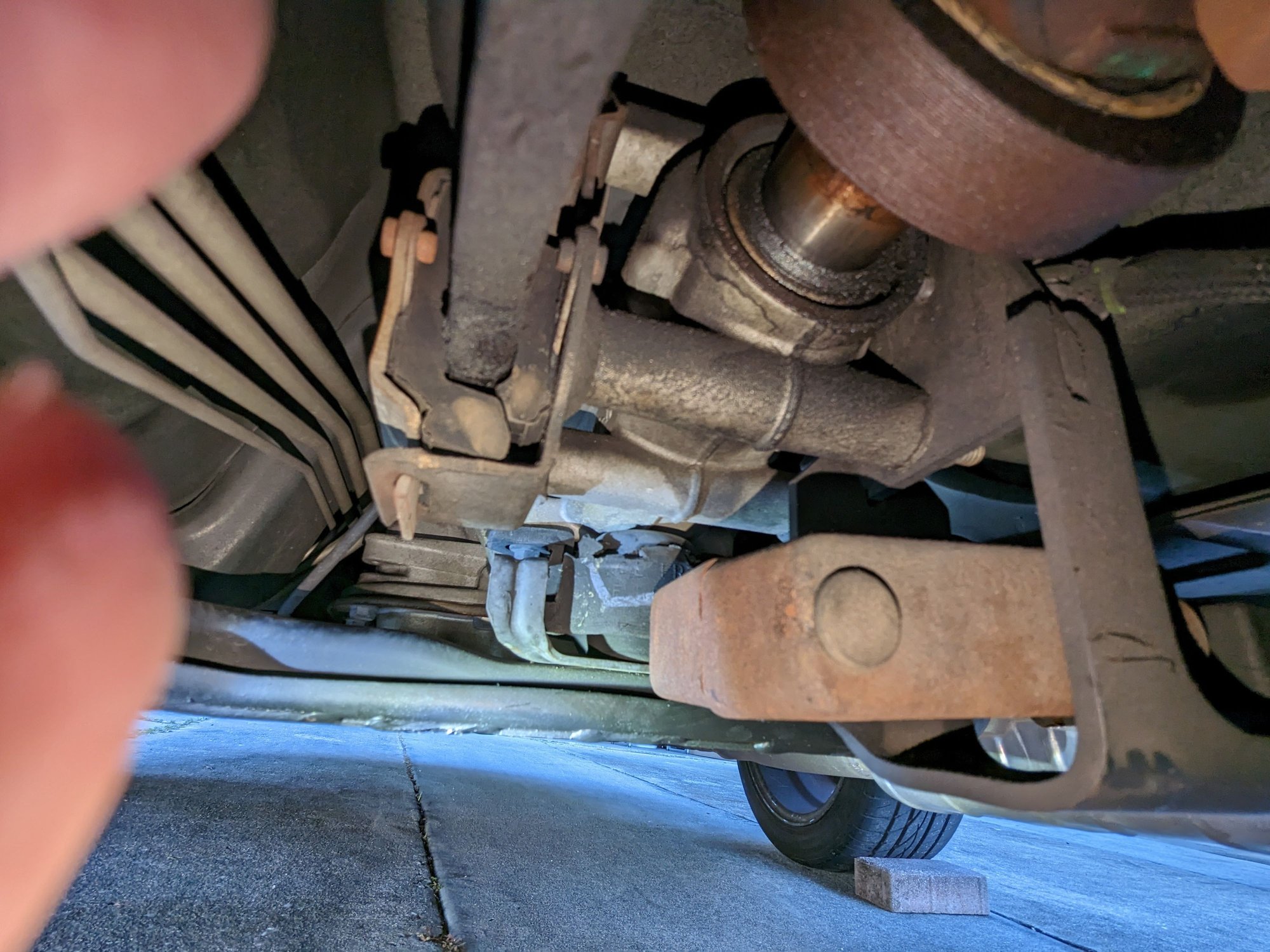

Input shaft seal leak, torque arm bushings and hydraulic transmission mount

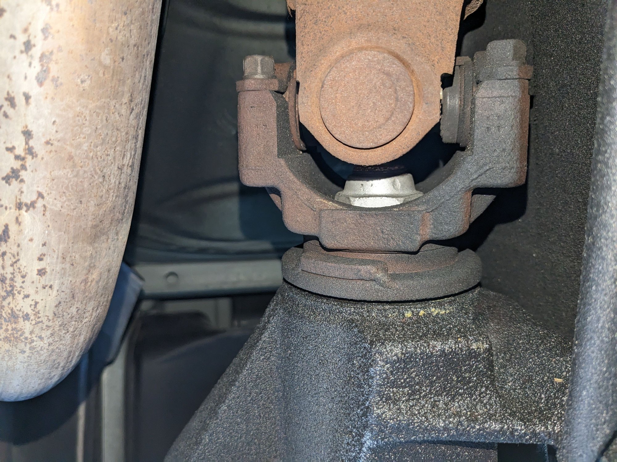

Leaking pinion seal. Is the gap from yoke to diff normal?
Leaking pinion seal
