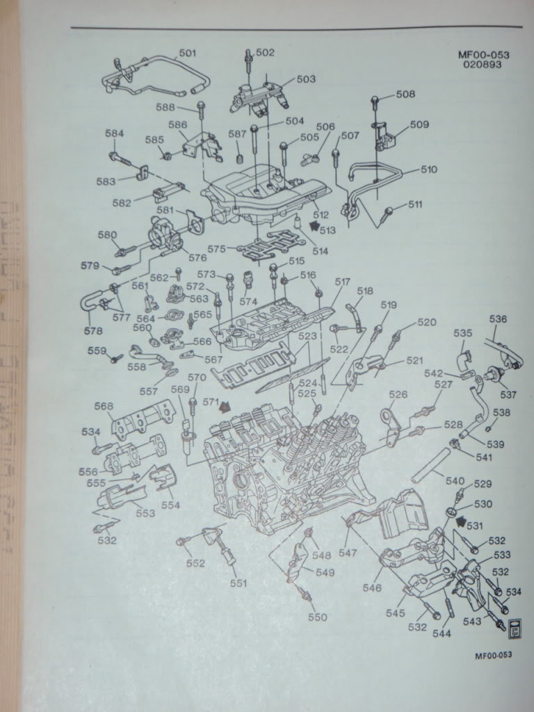

Old Aug 11, 2011 | 12:05 PM
  #18
Posts: 22,022
i dont know how the temp sensor is messin with the ignition but that looks like what it is. there are two sensors in that area, cam sensor (569) and temp sensor (525), cam sensor is held in with a bolt and temp sensor screws into the head.
