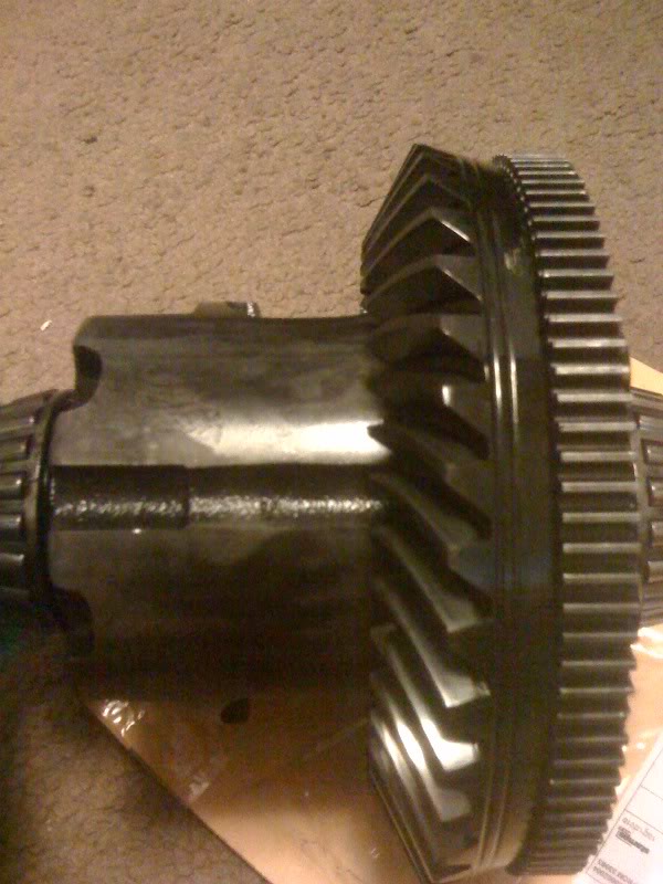

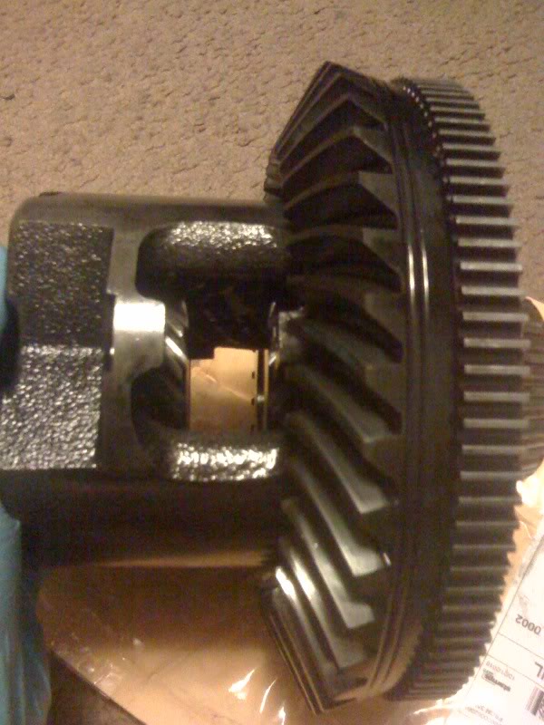

I just bought this... http://cgi.ebay.com/ebaymotors/ws/eB...0#ht_500wt_956 ...initially I was thinking it was cheap, and it'd be better to swap it out with the brand new one (as this has the ABS ring on it), and send the new guy back to Summit to try and get my money back..
But it came from a 2002 Trans Am - will this even work in my Camaro? It's 10 bolt, 7.5", so all good there. But upon closer inspection, I don't see a pin in the carrier... I'll post pics in a bit.

It said it was for my year Camaro (the listing)...

I would contact these guys for questions, and be sure to check out their carrier guide:
http://www.tacreationsusa.com/differential_carriers.htm
Also see their gears section:
http://www.tacreationsusa.com/rear_gears.htm

I've been looking ALL OVER for pics on the differences between carriers! Thanks a bunch for the links to sites.. this carrier is a Torsen, so I'll give 'em a shout I guess. I do have (allegedly) all the stuff for it; it seems I do anyway... I'll e-mail em and see if it works in my car.

If you have a 99-02, it should work.
