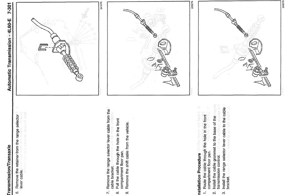

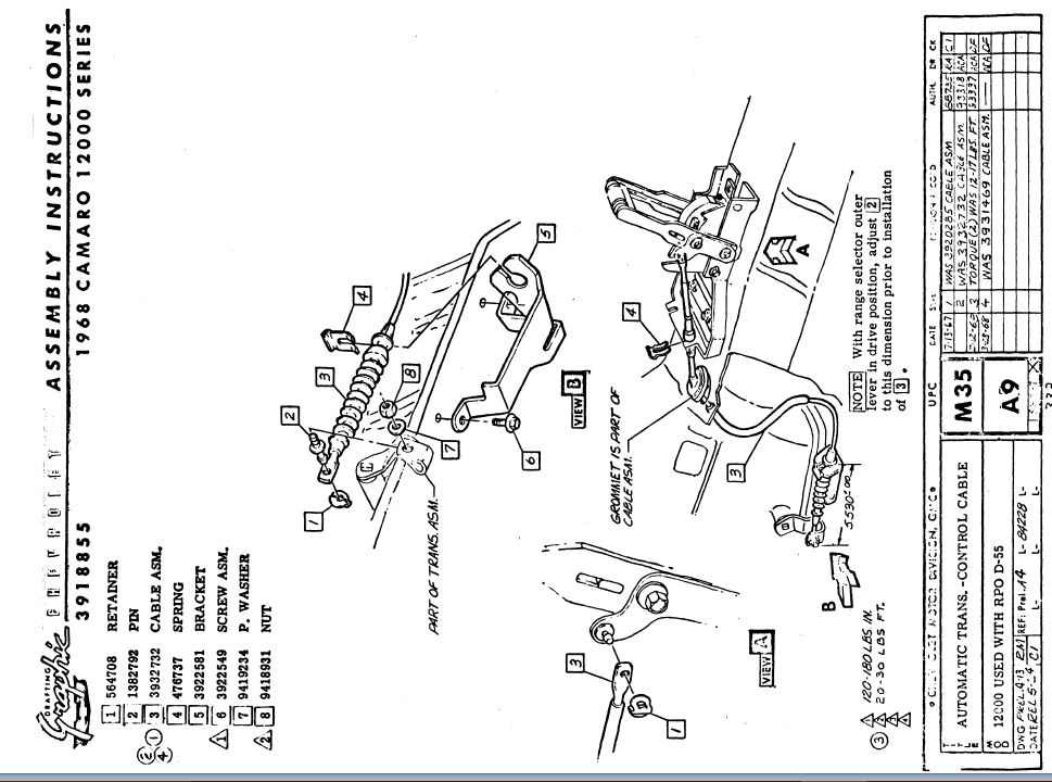

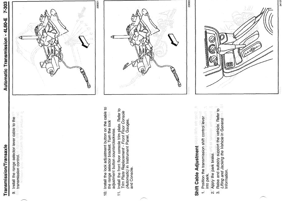

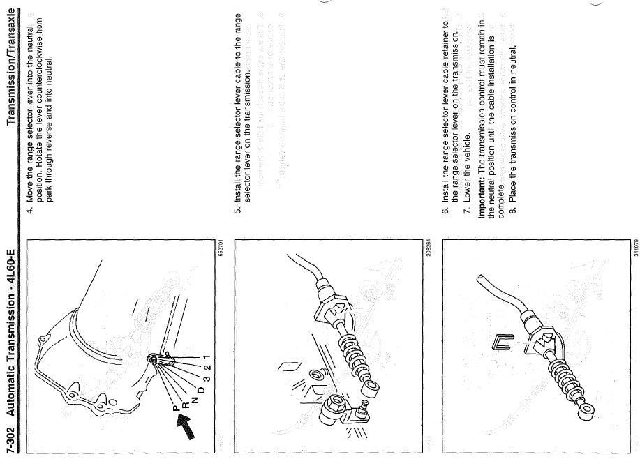

These might help from a 2000 Service Manual
Attached Thumbnails What's wrong with this Pic......-shift1.jpg   What's wrong with this Pic......-shift2.jpg   What's wrong with this Pic......-shift3.jpg   What's wrong with this Pic......-shift4.jpg   What's wrong with this Pic......-shift5.jpg
