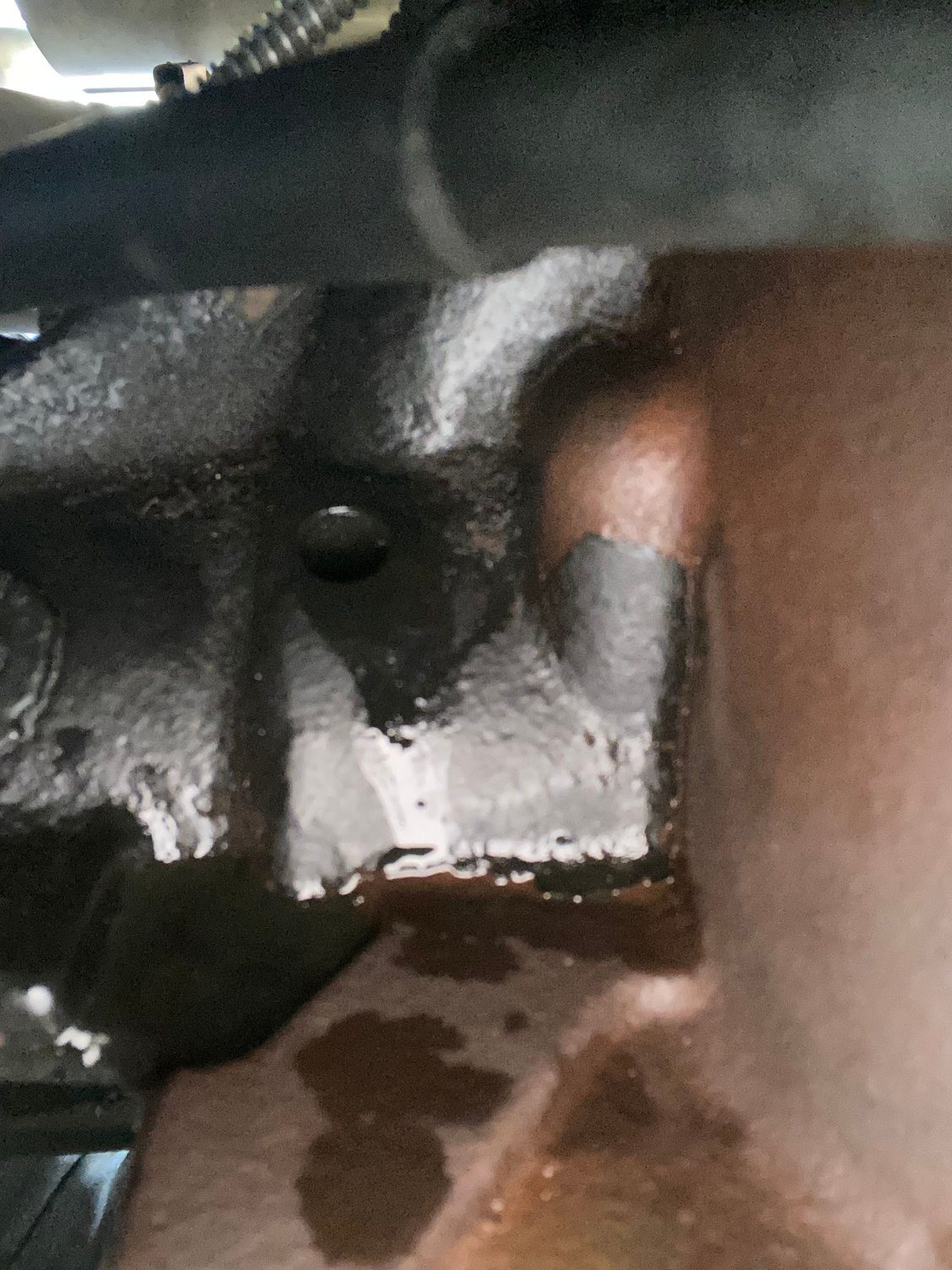

So have a rear diff leak on my 2001 Camaro SS. Seems to be coming from top right side, specifically seems to be coming from that hole. Not very familiar with GM 10 bolt. Is that the vent hole? Shouldn’t there be some type of vent in there? Lol
You can see the trail of fluid running down.

Yes, the plastic slip-in vent is missing.

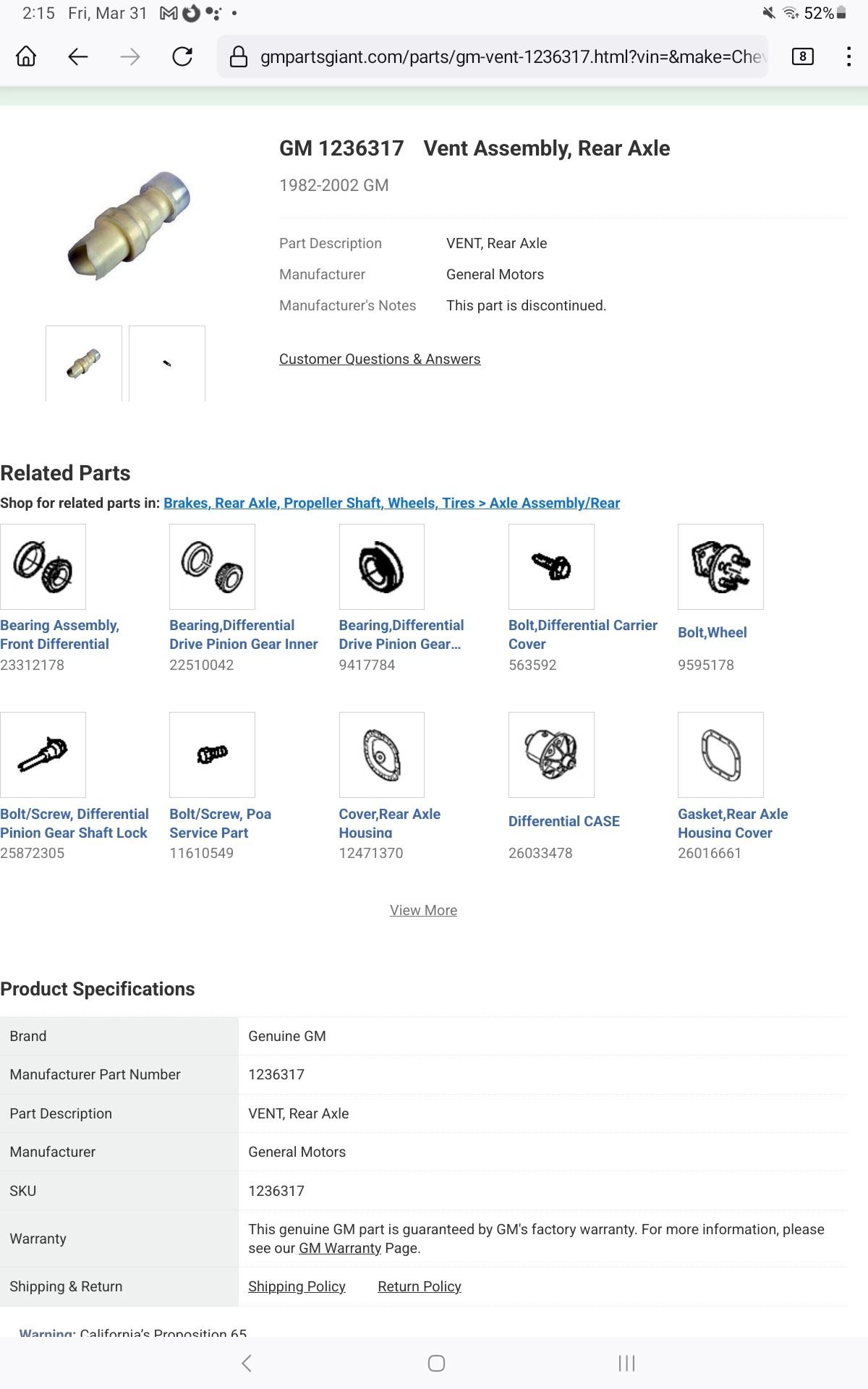

Default GM diff vent p/n 1236317
For the OP and anyone else looking for this part
The part is discontinued, but this picture at least shows you what looked like.
