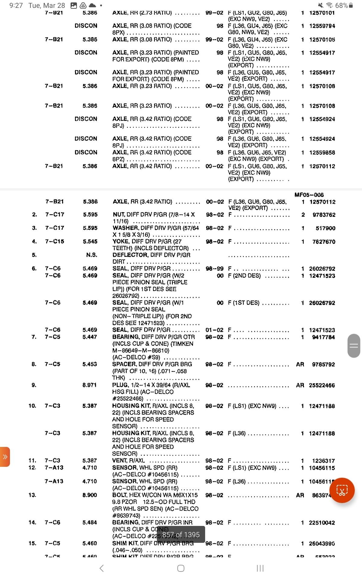

This is from craby's 93-02 GM Camaro parts manual pdf
#6 shows 2 pinion seals for the 2000 F-body:
1st Design is a 1 piece without triple lip
2nd Design...2 piece with triple lip
I'd prefer not to waste money buying both, as the one I don't use will be useless to me and cost more $ to return ship.
Q1: How can I find out which Design I have? Before I tear her apart

Default Found 1 answer
Wholesalegmpartsonline states:
1st design has 28 axle shaft splines
2nd design has 30
Just posting this for others as I won't know which one I have until I pull her apart and I already ordered both seals, jic, and will return whichever one I don't use.
