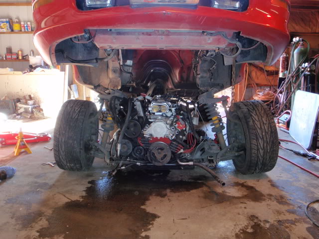

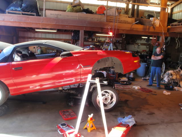

heres some more pictures
Size:  69.0 KB lifting the body.
Size:  75.8 KBnow i know y i need to take the tires off. lol

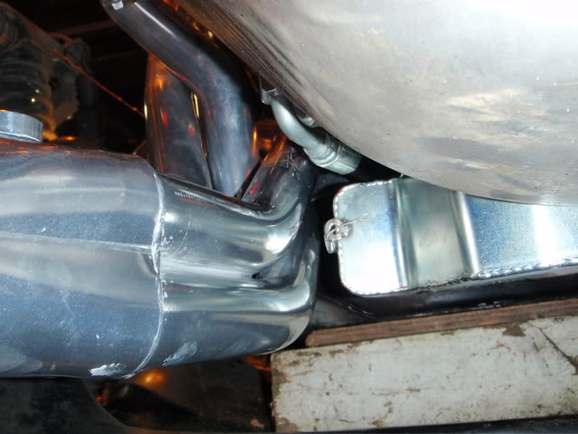

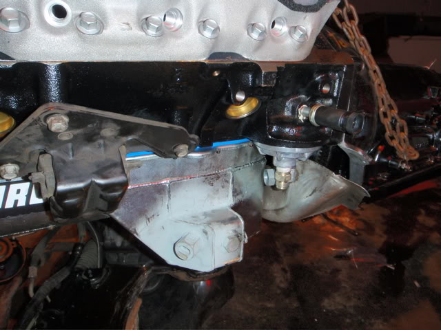

well i am still hung up on the oil filter and trying to get it relocated. cannot get the oil cooler to work in the stock location with the kooks and the moroso oil pan. i think if i didnt have that oil pan it might work but i wouldnt put money on it. i have another style filter relocator coming to see if it will work better than the trans dept one i got from bordens. the problem i run into is routing the hoses. they are to close to the headers and im afraid they will melt. busted the oil pressure sensor so i had to order one of those. got the wrong one from parts store, to short, i need the one that works on the 93 4th gen not the 94. hard to find but advanced has it so i have one coming. i am really not very happy with the way kooks are fitting or the service i am getting from them. called and wrote to em to see how they figure these are for my car. not a word back from em. i called summit to let them know that the kick out oil pan will not work with long tube headers without a fairly spendy modification.
Old Mar 3, 2010 | 09:38 AM
  #48
Posts: 22,027
kooks has finally responded and apologized for the mess. they have changed there catalog and no longer claim these egr headers will fit a 93 camaro. for u 93 owners there is not a egr header sold for the 93 by anyone that i can find. if u want to keep the egr setup u will have to use a egr system from a 94 or 95 and order the 94-97 egr headers. i did get a refund from maryland speed http://marylandspeed.com/index.php for my hardship and have gotten stellar service and pricing from them. i will be getting my corsa exhaust from them when i can afford. brandon helped reseach the fit and was very understanding.
on the oil pan summit has changed the wording in the applications for the oil pan to let consumers know lt headers will require modification or will not fit with the pan. i hope all this helps some guy in the future. lol
