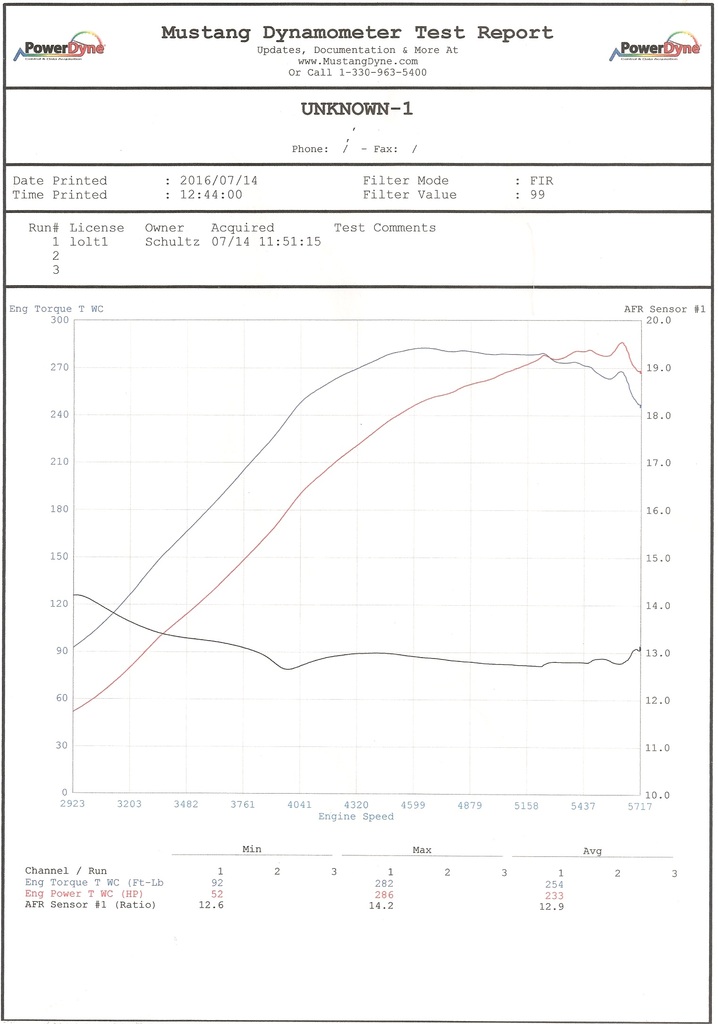

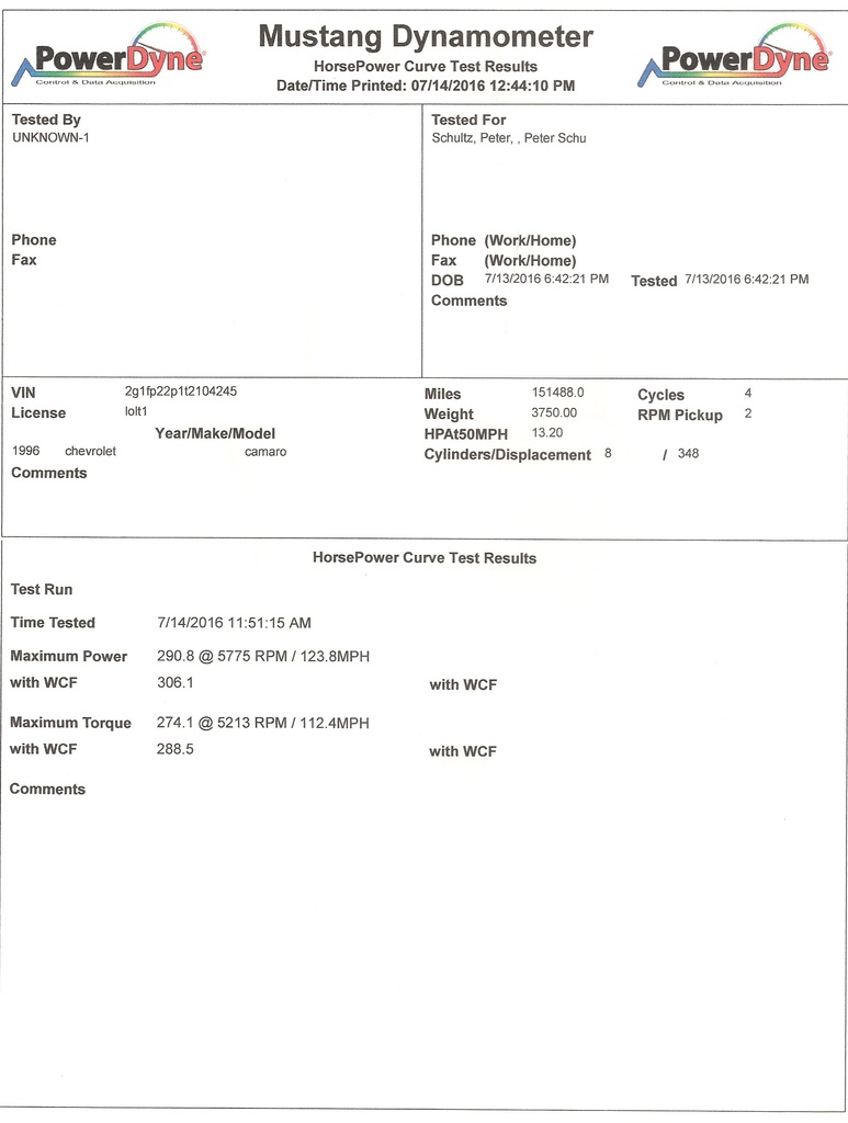

Took it in for a dyno tune last week, just got it back a couple of days ago. It definitely still has some bugs to work out, but other than that it was a blast! Here's the dyno results:

As you can see it has some pretty significant ignition issues up top. I plan on swapping the ignition coil today. I'm hoping that's the problem, since the Opti, plugs, and wires are all new. The coil is from my old engine, which also had issues that high in the revs, so I think chances are pretty good that takes care of it. Once I get that and an exhaust leak resolved, I'll take it back and see what she'll do! I'm fairly pleased with the numbers as-is, especially since it did 215hp/252tq last time I got it dyno'd in 2012

tuner have any ideas. nothing telling showed up.

They said it could be any one of a number of things. The opti, plugs, and wires are all new. I replaced the coil on Saturday night and did a couple pulls on the highway. It's improved, but not 100% fixed. I guess the next thing to try would be a new ICM.
