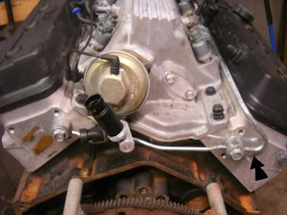

No, I do not. When I ran it for about 30 seconds last night, it didn't throw any misfire codes at all. I have bigger problems, though: while running it, I found I have a massive coolant leak--and no idea where it's coming from. I got the car up on stands and poked around underneath for a good 20 minutes and for the life of me couldn't tell where the leak was coming from. The puddle was forming on the passenger side, near the end of the header. My first guess was heater core, but there was no coolant pool on top of the heat shields on that side and there was no evidence of coolant leaking out the heater hoses or down the firewall. Didn't look like it was coming from the sensor, either...

Old Mar 11, 2014 | 07:59 AM
  #665
Posts: 22,042
check your crossover pipe. may have hit it when working on her.
Old Mar 11, 2014 | 08:48 AM
  #666
WIspartan1026's Avatar
May 2013 ROTM
Posts: 1,671
From: Farmington Hills, MI
crossover pipe? what's that?
Old Mar 11, 2014 | 11:49 AM
  #667
Socom's Avatar
November 2010 ROTM
October 2011 ROTM
Joined: Jan 2010
Posts: 1,104
From: Maryland
This. the tube connecting the heads.

Old Mar 11, 2014 | 02:14 PM
  #668
May 2013 ROTM
Posts: 1,671
Ah, yes. That would definitely make sense...I'll check it out.
