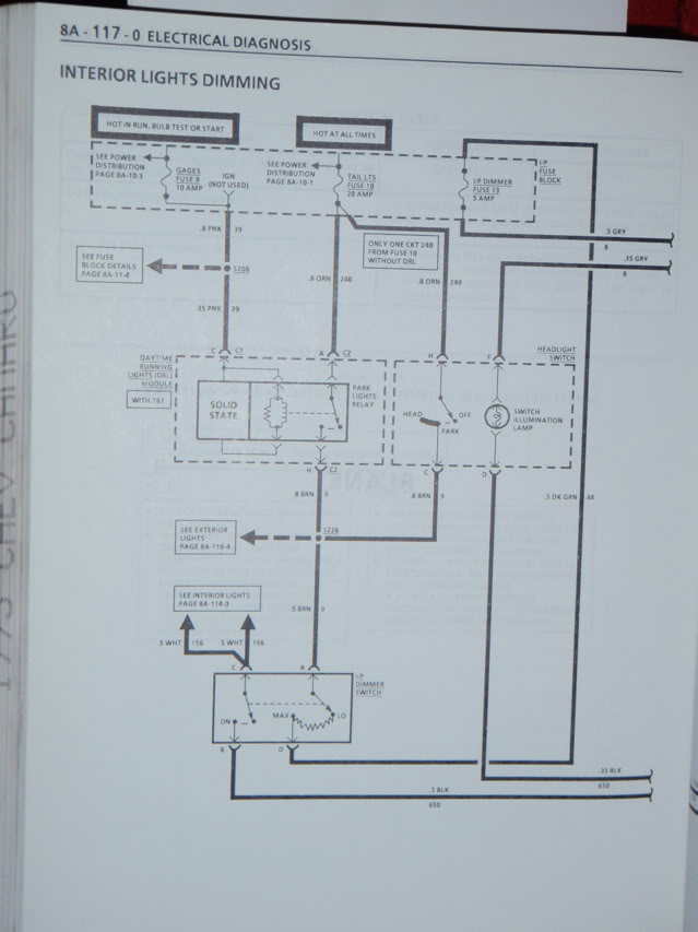

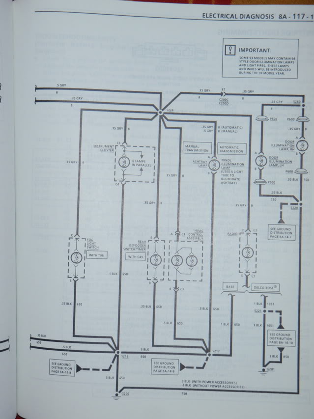

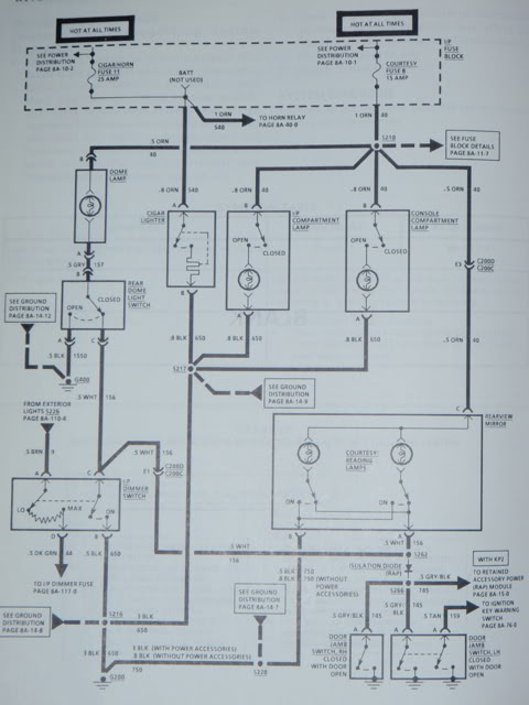

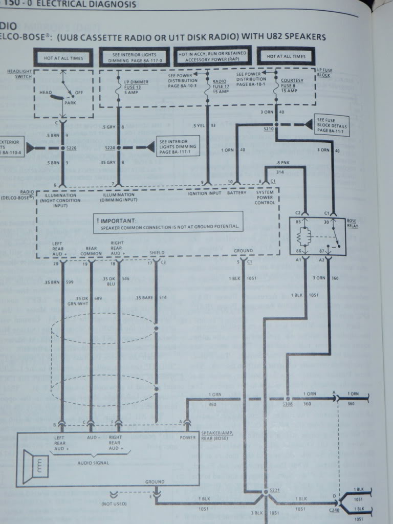

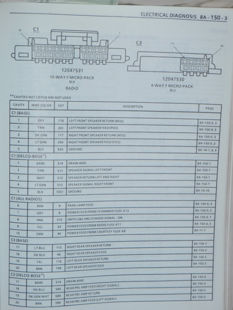

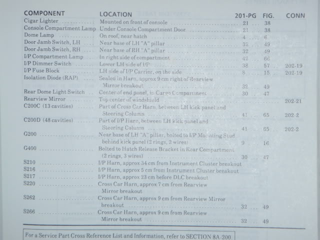

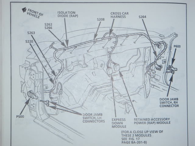

what year, this is for 93 Name:  P1130001.jpg

It is a 1999 V6
Old May 8, 2012 | 04:09 PM
Posts: 22,027
in that case im not going to be much help. should think on picking up a factory shop manual for your year
