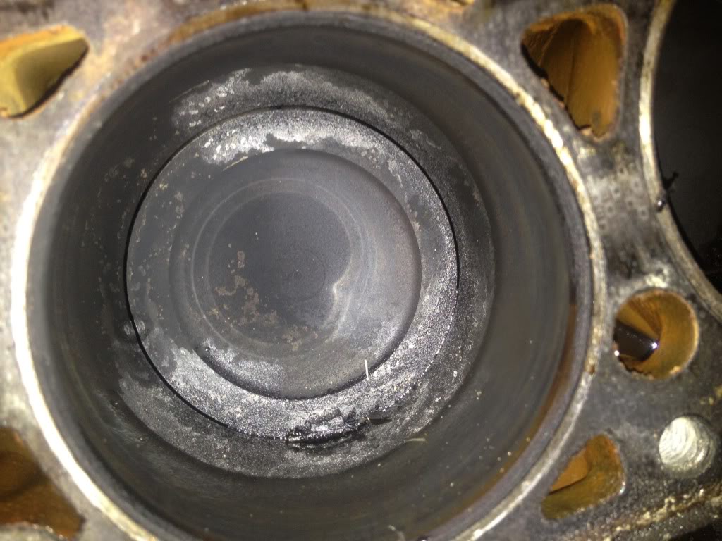

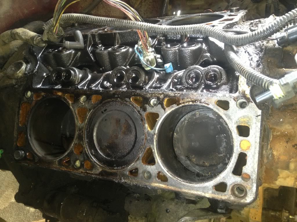

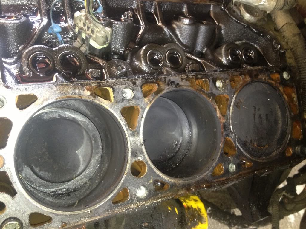

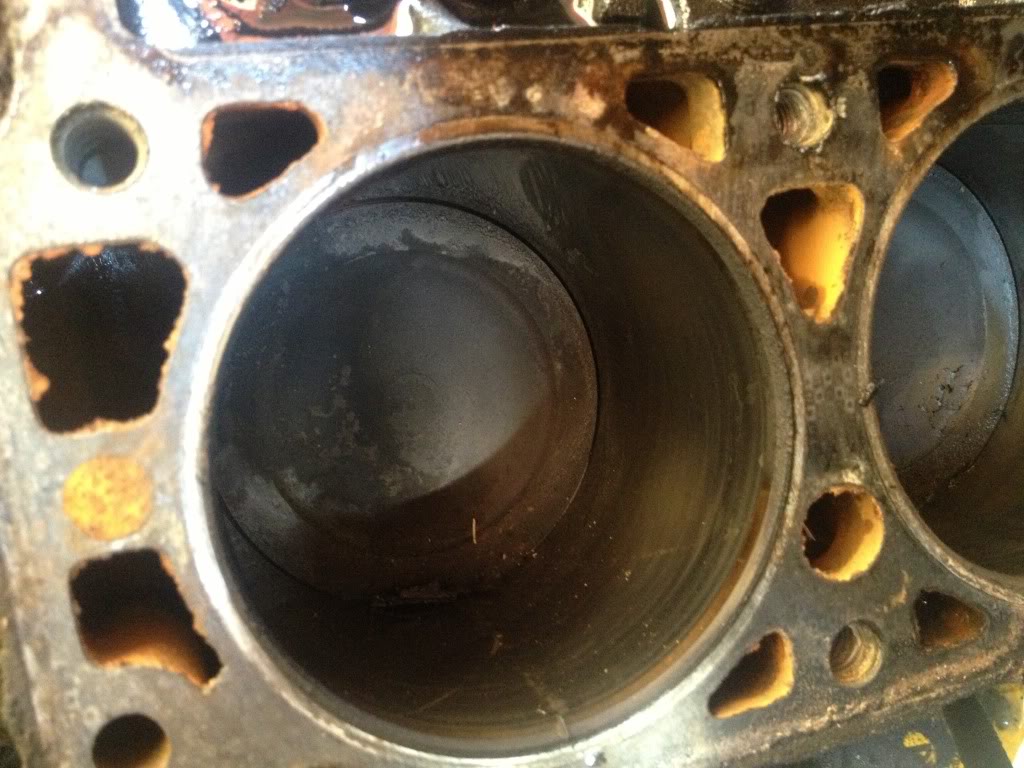

It's actually not too bad from what I could tell. The drivers side gasket looked like it had a break between the front most piston and a water jacket. The piston itself has burn marks from water on it. Hopefully we have found the culprit. I can't afford a new block or heads... Lol

I'm sure its fine, cut gaskets do happen from time to time.
Are the head bolts on the v6s torque to yield? You may need a new set when you put it back together

Passenger side:

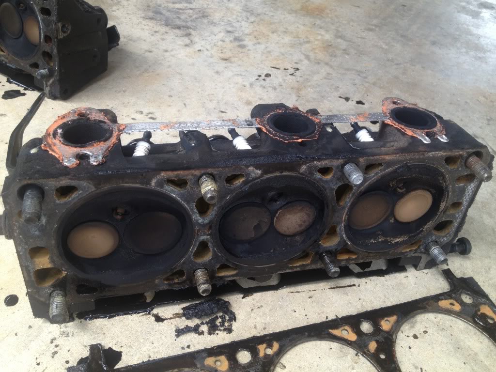

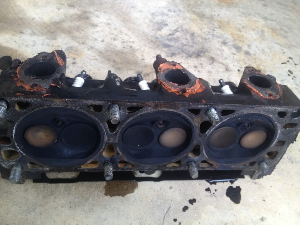

Drivers side:
Old Jul 2, 2013 | 12:21 PM
  #14
Chaotic94's Avatar
September 2011 ROTM
Joined: May 2010
Posts: 3,402
From: Missouri
Went ahead and bought head bolts when I bought the head gasket set. All in all cost me $85.

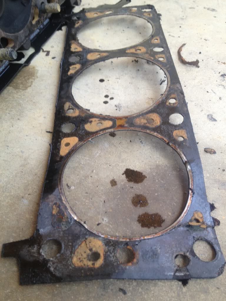

Was it the upper right water jacket? The metal on the block looks stained, unless that's picture glare.

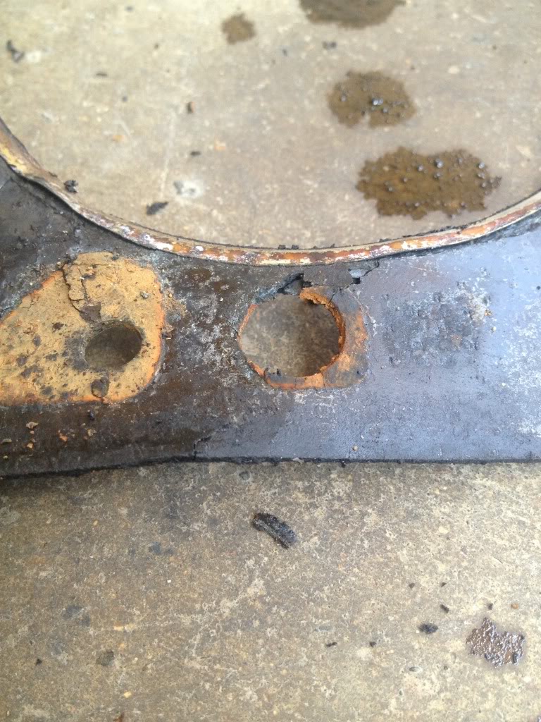

Ill take a pic of the gasket
Old Jul 2, 2013 | 01:49 PM
  #18
Chaotic94's Avatar
September 2011 ROTM
Joined: May 2010
Posts: 3,402
From: Missouri
Soooo? What do ya think?
Old Jul 2, 2013 | 02:29 PM
  #19
Cheeks's Avatar
August 2011 ROTM
Joined: Jun 2011
Posts: 735
From: Pittsburgh, PA
I don't see anything that points to something being seriously wrong. It sounds like you just plain got a gasket. At least its not an expensive fix
Old Jul 2, 2013 | 02:31 PM
  #20
Chaotic94's Avatar
September 2011 ROTM
Joined: May 2010
Posts: 3,402
From: Missouri
Does the gasket look like it failed?
