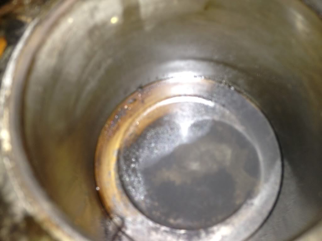

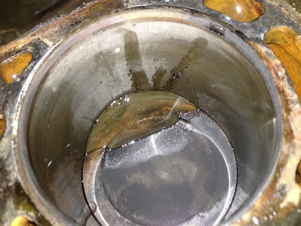

Uh guys... Back passenger side piston....
Wiped it out
Ideas?

It's not uncommon at all for coolant to go down into a cylinder when you remove the heads. Is that all you were reefering to, or is there something more that the blurry pic doesn't show?

Sorry about the blurry pic. iPhone is all I have to post with lol. It was just water in the cylinder. Didn't know if that should worry me or not lol

Not at all, its common for water to run into the motor when you're pulling the heads off

Okay good. So far no signs of cracks! I'm gonna take some carb cleaner to the heads later with a wire brush and clean them up real good. I get off work at 9:00pm so I'll clean them up when I get home and let you guys know if I find any other damage lol
