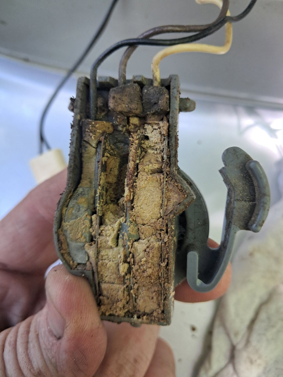

Re: Tail light sockets: Does anyone know what to replace that dried out grease packed in between two piece socket body/electrical connectors? It has the consistency of dried play-doh. Also, is there a tail light anywhere in the universe that doesn't leak? An LED set would be nice.
You know if Chevy didn't have such a ****-poor design, the sockets wouldn't need such a glob of splooge in the socket body.

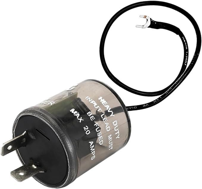

Has anyone used the 1156-57 LED bulbs? They're not crazy expensive, like $3-5 apiece.

yep you will need a electronic blinker flasher.

-Do you still need a flasher if you splice in a 6 ohm resistor? Just swapping out a flasher/blinker would be quicker.
-Is the flasher with the external ground wire required? I've read it's for the audible "click" function like normal flashers.

I just switched to an electronic flasher. didnt see one with the ground when I did it.
