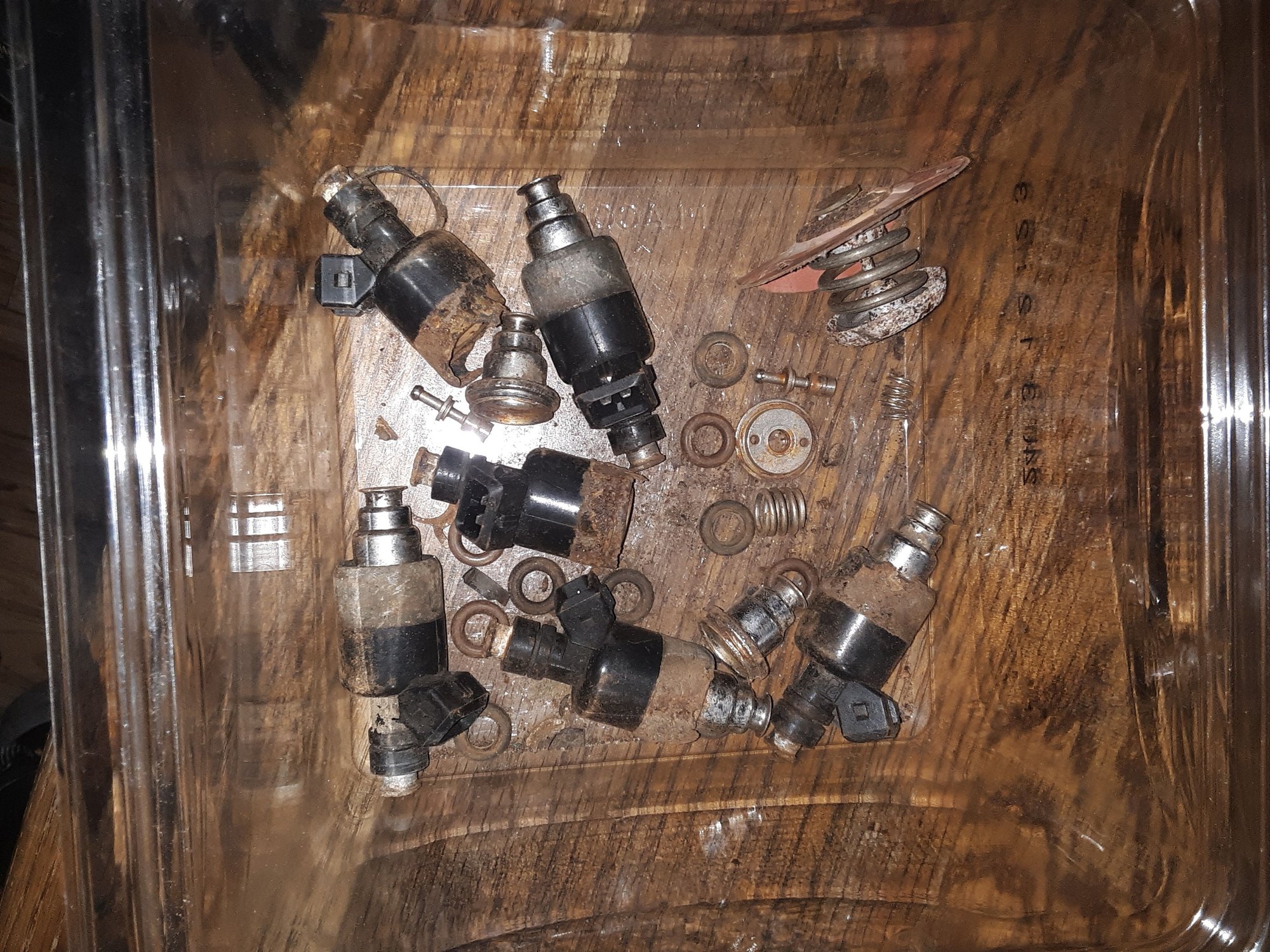

You called it Gorn. I cleaned the fuel rail and put a new regulator & injectors on it. It wouldn't start (yet) but you could tell it wanted to. The generic fuel pressure tester was showing 30-35psi at prime but never went above 30. It held at 30 for a few minutes but slowly bled down over the next hour or so. I thought maybe the check valve in the pump might be bad. I then put some new plugs and fresh oil in it. After a spritz of starter fluid, it fired up with some pedal feathering. The engine sounds wonderful, especially after sitting since 2009. Unfortunately, I can't get it to idle. All vacuum hoses look good. Zero fuel leakage from rail to pump. It doesn't cut out at all as long as I keep the pedal down a bit. I'm thinking MAP, IAC, or maybe the pump still. I haven't checked the pressure again since getting it started so I'll do that first manana. Ftr, I did an "EGR Delete" to access the plugs more easily-built my own block plates- no leaks.
Could it run with just 30 psi? Will a simple ohm/voltage test for sensors be good enough? Could the ECM need tweaking with new injectors?
I know now for sure the original problem was an injector or two. The motor hasn't sounded this good since I got it with 53,000 miles on it. The #1 cylinder intake valve's cam lobe was supposedly the one that flattened out. It wasn't. All the cylinders are firing just fine. I can't effing believe this entire time it was a relatively simple fix.
OEM injectors & regulator.

If the injectors are at stock flow they should not need any program tweaking. It when you start messing with higher flow injectors you need to change the mapping. I have seen guys use adjustable fuel pressure regulators to tweak their fuel pressure at the track but that was before everyone had a laptop to fix it right.
No, 30 PSI is not enough to run your engine. You will need to sort that out. The amount of fuel that enters the cylinder has a very small band of error. The reduction of fuel that enters the motor cannot vary 30%. The system is designed to allow the fuel pressure to run within its spec. but once it drops even 2 PSI below its allowed variation you can get a check engine light. 3-4 PSI the car would run poorly I would expect it not to start at 10 PSI below. In fact I would not want it to start at that fuel mixture if you could drive it you would probably melt the piston. Idle would probably not hurt it but it would lean back fire and the cylinder temps would be twice normal.
You may have to do some more diagnosing on the pump and maybe clean out the tank. There is a sock at the bottom of the pump that work like a filter and if the car has been sitting that could be partially plugged. Because of the sitting you should do a voltage drop test to see if you are losing any voltage or a ground. It may be more simple to just run two large wires right from the battery and see if the pressure get better. I would not run the car that way but,,,, If everything is clean and you have good voltage you probably just need a pump. Its pretty common failure on these cars. The pump is a pain to get at you may want to search out "Hatch method" on this sight. This shows you how to cut a small hatch to access the pump. Turns it into a 1/2 hour job. In my opinion the hole is not large enough to effect the strength of the unibody and the lid you use can be thicker than the metal you remove. if you are worried about it. The last pump I put in I bought a cheap one for my V6. I ended up replacing the pump 3 times in 6 weeks. Sure glad I did the hatch. I can't even imagine how pissed I would have been if I had to remove the exhust the rear and the tank 3 times.
Do not use a shop vac to suck out the gas tank. The gas fumes and 120v motors do not play well together. Do the research. Don't take offence to the that statement. I always assume other people will find this post and I do not want to be the reason some 16 year old burns his family's house down.
