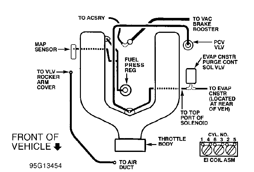

--The "Evap Cannister Purge Control Solenoid Valve" was completely clogged as well as the vacuum line end connected to its top port which was also jam packed (a half inch or so in from the lines end) with carbony-looking charcoal granules b4 I cleaned it. The diagram shows it isolated to the intake manifold and the pcv valve on the engine side. Would this affect idle?

evap canister has gone to crap once that happens the charcoal can get in everything its connected to and can effect idle. the canister has charcoal in it and when liquid fuel gets in it the charcoal gets into the system.
vacuum leak in the intake manifold gasket area is common with aging v6s in the 4th gen. never tried it but have seen on here, while engine running, guys spraying start fluid lightly in areas like gasket areas and hoses to see if idle changes indicating a leak.

Ok, cleaned tank, blew out all lines, installed new filter, put pump back in, filled it with 7 gallons of gas and none of it mattered. After priming a few times to get fuel circulating, it fired up as before but this time it idled perfectly. I stepped out with it running and noticed there was a huge vacuum leak. Then, I remembered, earlier, I pulled off the front "t" fitting that goes to the pcv valve and the solenoid. It makes it easier to twist on the fuel pressure gauge connector. Well, lucky I did because as soon as I connected it, the car died immediately. Disconnected it and boom, it idles great. Of course it whistles like crazy. At least I know now that the effing *** clowns (Todd & Co.) at Today's Technology in Carbondale, IL either GROSSLY misdiagnosed my car a second time 15 years ago OR they tried to rip me off $1500+. Neither bodes well. Their first diagnosis I don't even remember (who cares) was something less than $300. The second diagnosis was a bald cam lobe (intake cyl #1) which was $1500. Well, I could not afford it at the time and parked it for the last FIFTEEN F*CKING YEARS!!! The only thing wrong was the injector(s), And, probably only one injector at the time. Anything else: tank cleaning, contaminated fuel system, pump, & regulator was my fault/neglect and a direct result of the car sitting (outside) on the edge of the Shawnee Forest for 15 years.
That said:
I assume a new pcv valve should fix the vacuum issue?
