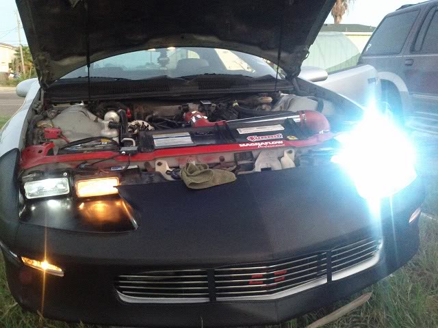

So I thought it was fixed and it started blinking again. I switched the bulbs and the ballasts and they are both good. It seems like its just the right side of the car. I asked Xenon about it and they said they can send me a new bulb and ballast but it probably wont do anything.. Im so confused. When I touched the ballast on the right side it was SEARING hot . Here is a pic

It looks like it's lit but I took a pic when it was blinking. Oh and above the rag, thats my professional painting for ya
