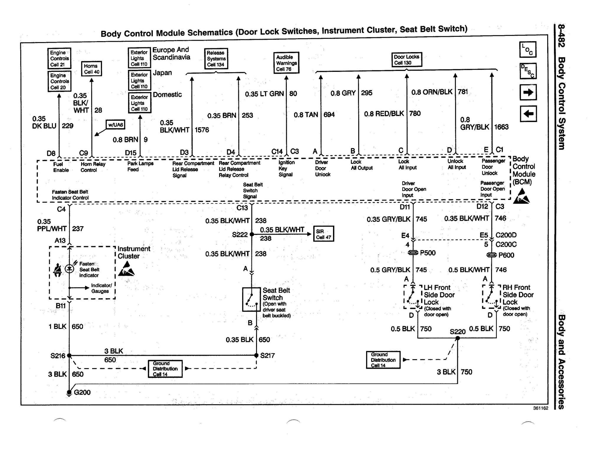

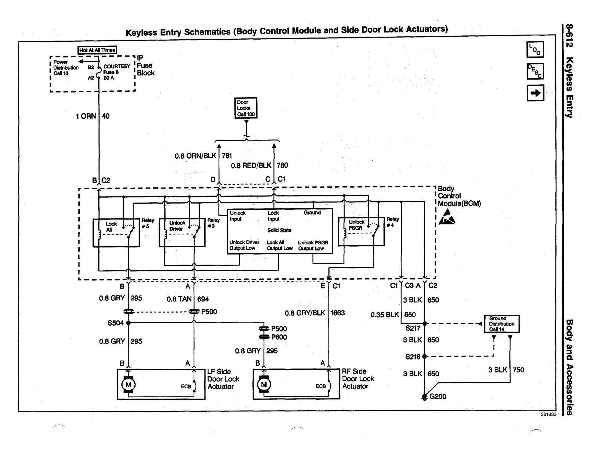

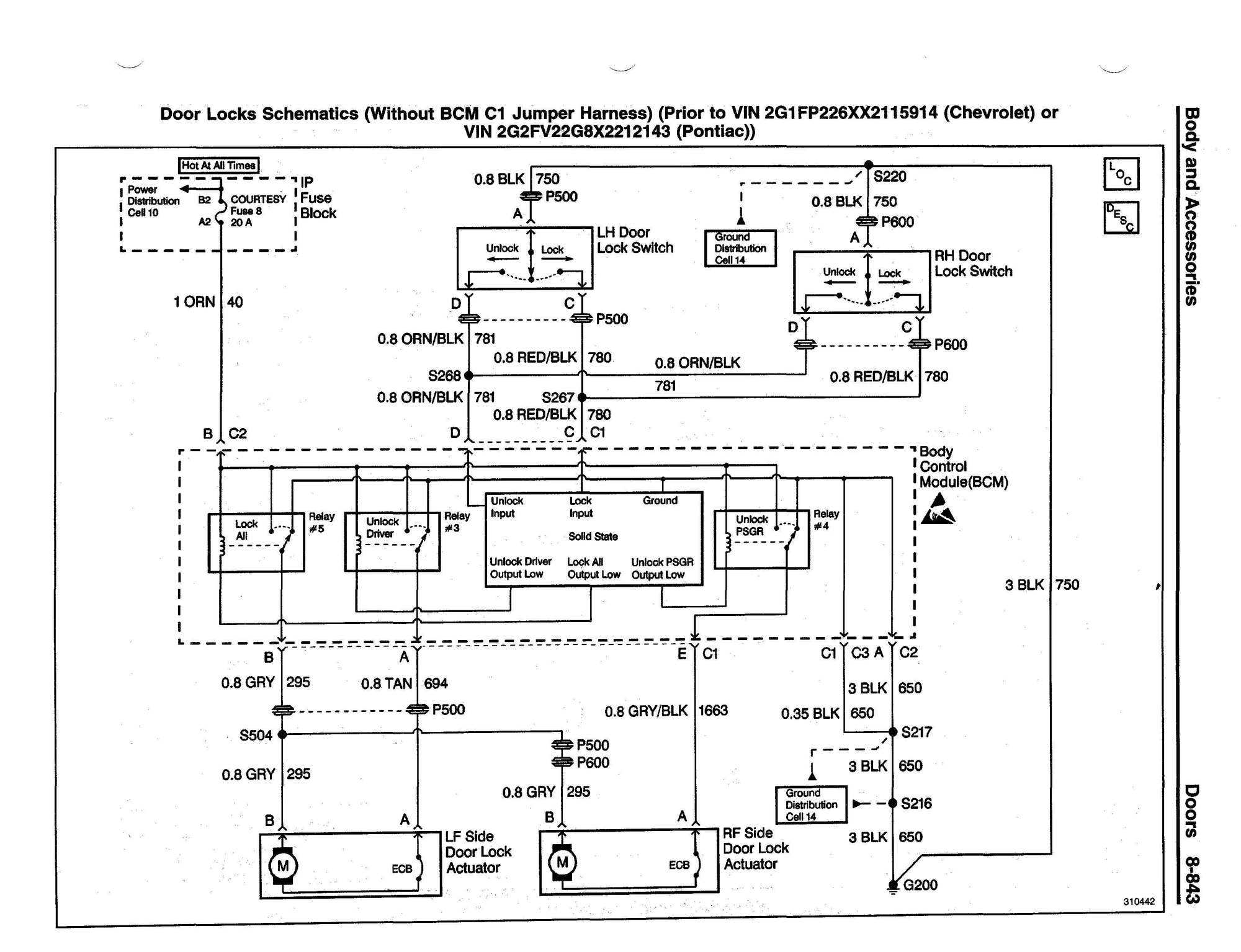

The gray and tan wires should operate the lock solenoid and the black and gray/black wires are for a door open input to the BCM. Here's a couple of schematics that may help explain how the circuit is wired.

Yes, but I wouldn't use the term "shorted" because to me, that infers there is a problem with the circuit being damaged and grounded because of this damage. The internal BCM Door Lock Actuator relays are always hot and if the BCM circuit board doesn't provide a ground to the relays to energize them or the relay coils themselves are damaged, the actuators in the doors won't operate. The door lock switches provide the BCM with a ground input, so check them for the correct operation to rule them out. The schematic below shows the door lock switches wiring.
