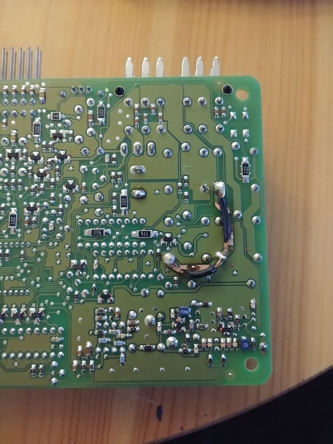

So I was taking out some old stereo wiring and a lot of what was connected around the bcm wiring i tore out... Little did i know i took apart some wires that allowed me to lock and unlock my car with my key fob. Well i was able to get the fob to lock the car but not unlock so i crossed two wires and pop.... There goes my bcm.... How can i fix this issue? Will post pic

If you can use a soldering iron, this is easy to fix. Two ways to do it:
Method 1 uses one long bare single strand wire to join all 3 component leads together. I would loop the wire around at least the two end ones. Then apply solder to the end ones and the lead in the middle of the trace so the solder flows joining the leads and the wire.
Method 2 uses two short bare single strand wires to bridge just the damaged areas.
A small 30 watt iron should work fine and be cheap to buy. Buy a small amount of solder also if none comes with the iron. You can practice a bit first before doing the repair. For each method, use one hand to hold the heated pointed end to the circuit trace and the other hand to feed the solder. Don't hold the iron to the circuit board for more than a few seconds at a time. The solder only needs to be in 3 places for method 1 , or 4 places for method 2.
If you don't feel comfortable doing this, find a friend or neighbor who does.
By component leads, I mean the silver colored areas. By trace, I mean the bare copper areas.
Don't allow the solder to "bridge" to adjacent circuits

thanks Gary! I can do rhis no problem as ive already fixed the radio, window components last week. Now i just need to find the correct wires that will allow me to lock and unlock my doors using the after market alarm that was put in. Ive got power to lock but i cannot unlock using key fob... All was fine before ripping out old stereo wiring and what not..
But again, thanks! Ill try this right now

It works great! Not so pretty but it saved me from a trip to the junkyard or buying one from ebay. Check the pic! Heres my bridge work lol. It works though! This connects the power door locks
