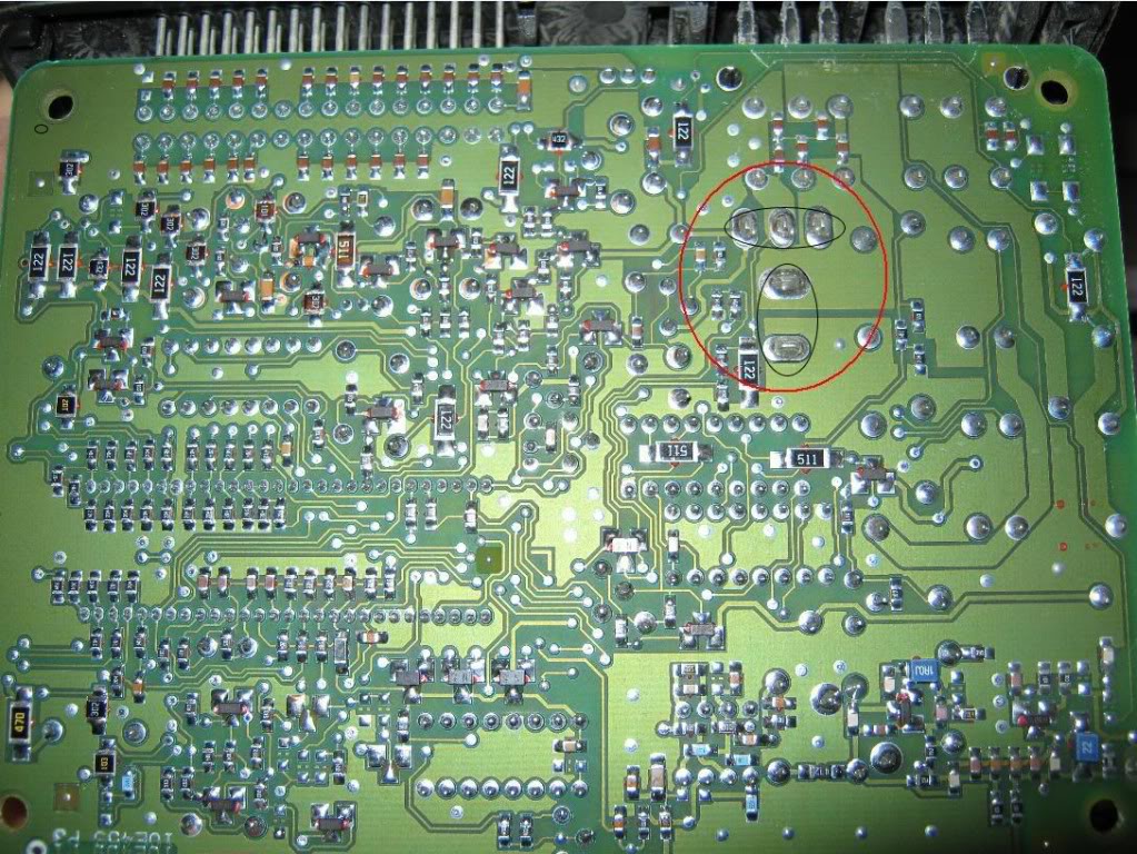

I got those symptoms with my new-to-me 1998 Z-28. Found out about the BCM, and a reflow (re-solder) of the pins fixed everything for me.
For anybody who has trouble with soldering, I work in electronics, and FLUX is the key to success. I can help. Do not use acid fluxes on electronics. Rosin fluxes are lame, but might work. Never leave flux on a finished job, it just causes problems. Wash/scrub any flux away, before you call the job Done. This is a great flux for anything from electrical to plumbing (non-acid, and safe for use on drinking water pipes). Wash away any of this flux with water, not chemicals, when done. Two ounces is all you need for many, many repair jobs.
https://markal.com/products/regular-...=9204786921519
HTH.

I got the board out of my BCM and used a Weller soldering gun to heat up the joints and flow new solder unto them. The bottom of the "T" was the coldest solder joint I have ever seen. Just to be sure everything worked properly, I plugged the board back in to the circuit under the dash to try it out. The radio works fine, as does the power windows, but the ignition no longer works. What the heck happened??? I got some solder overflowed onto the little component marked "122" next to that lower cold joint, but I heated it and cleaned it off. Did I fry something? BTW, GM should get a letter of comendation for thier fabulous soldering process. Shouldn't this all be covered by some sort of recall in that it is so common with their vehicles?
Attachment 15526
I agree! GM should have recalled this. The sad part is the problem persists. I have a 2013 Camaro with the radio going crazy. The dealer is (now) saying the cause is the BCM. Every Camaro owner encountering this should report it to the NHTSA. If they get enough complaints, they’ll investigate.

Discovered on a different forum several years ago about poor soldering on BCM boards while researching intermittent windows and radio problem.
It was a bit of work to get the BCM out of my 2000, but doable. If I remember right that writeup said the joints in question were larger than most and made a cross shape on the board. I could actually see a crack in one joint.
New BCM was a few hundred plus needed dealer to program. Took my board it to a computer repair guy. He resoldered. Cost me $10.
Been working great for years.
