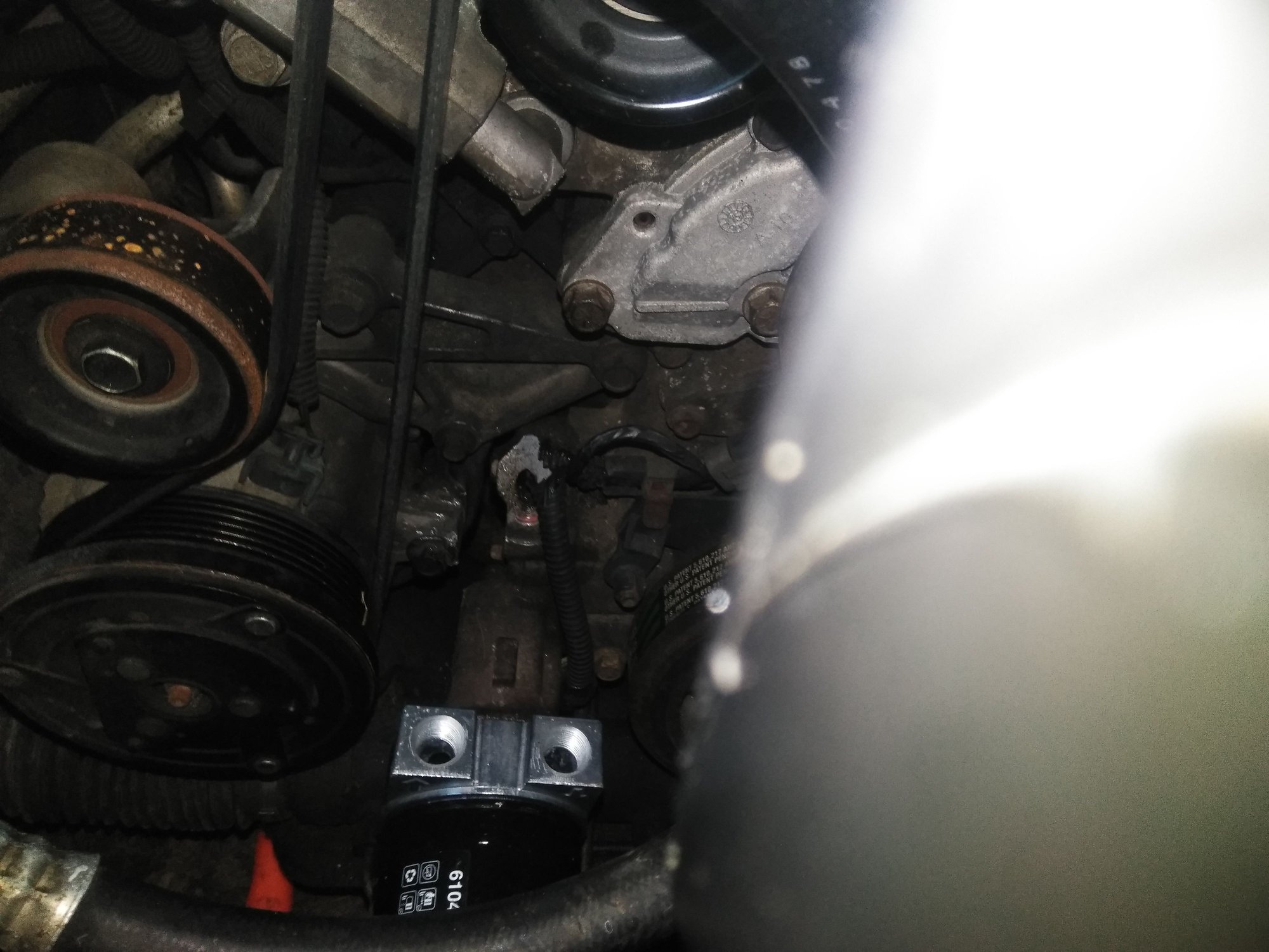

Hi
I recently acquired a 98 3.8l Base. The oil pressure dropped and the oil was full. I bought a new opsu and over torqued it and broke off the top of the housing. Instead of replacing the housing I was wondering if it's possible to just seal off the broken housing and put the sending unit on a sandwich adapter? Thank you for any help you can provide.

He broke off the oil pressure sending unit, and wants to install a sandwich adapter between the block and oil filter, to then screw in a sending unit there. Answer is yes, that's what they're made for. But what is the plan to cork up the remains of the snapped off sender, tap and thread a bolt into the hole?

Default How to fill in this hole I custom made
I put the sandwich adapter on and I'm gonna install an oil cooler...what would be the best way to seal the hole I created by being a jacka#$?

holy crab you broke the adapter. if the hole is deep enough and round enough tap it so you can screw a bolt in it. did a quick look for camaro 3.8 filter adapter and they is not around that i can see.

I couldn't find that part online either...that's why I was wondering if it is ok to just seal that off... I don't wanna ruin the car...maybe a bolt and jb weld or weld some metal to it....the piece that broke off crumbled...

try this place. also call around your local wrecking yards and see if they got one. Buy GM 12569217 Adapter, genuine OEM part
