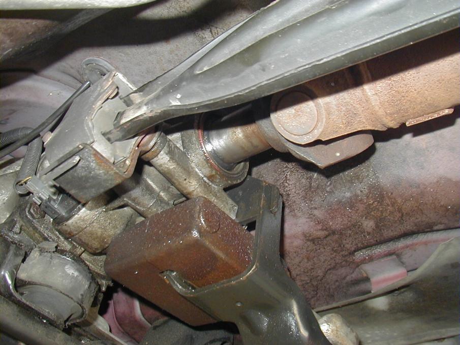

Here's the area they are talking about:

yes thats exactly what i was talking about i was gunna take a pic when i got out of work but you beat me to it lol
Old Sep 15, 2010 | 02:47 PM
Yes that's exactly what I was talking about what B.C. was talking about.
I had no plans to post a pic so you didn't beat me to anything, heh...heh!
