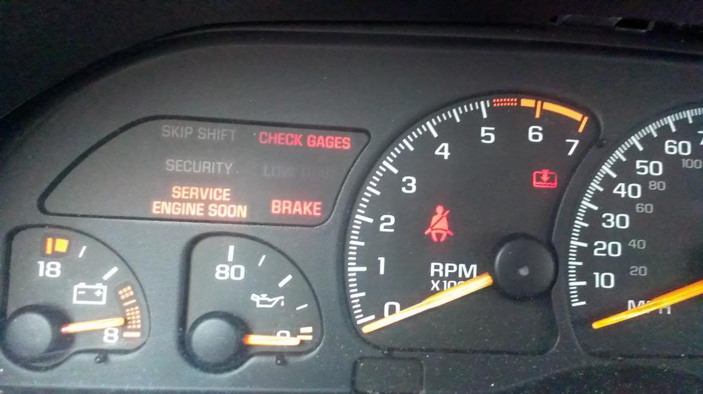

so you definately think it is the ignition switch? heres a picture of the dash. Name:  comethruuu_zpsda674f63.jpg

test the wire going from ignition switch to the solenoid on the starter. coming out of the ignition switch it would be the yellow wire. it should only have power to it when the key is turned to start. shbox is good, heres a wire diagram http://shbox.com/1/starter_charging_95.jpg
