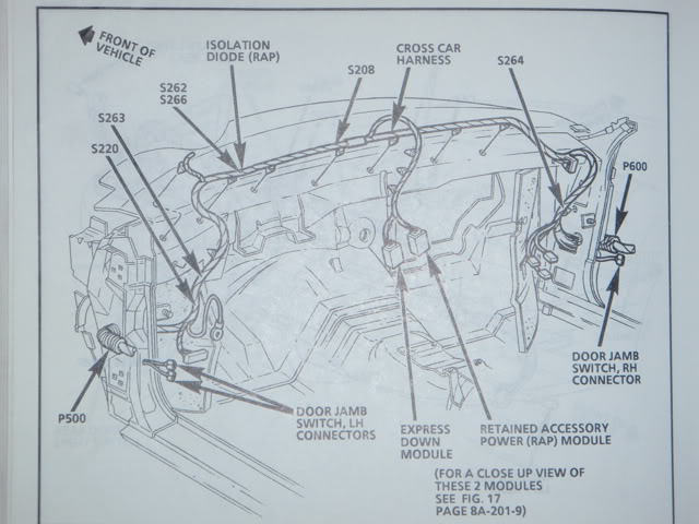

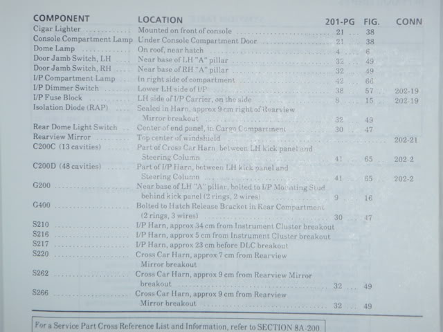

Old Jul 22, 2010 | 02:46 PM
Posts: 22,022
well im showing one ground under the driver side kick pad, you can see it in the last picture, the lone wire with the bolt like connector on the end. hope this helps.

Old Jul 22, 2010 | 10:58 PM
robmnrd's Avatar
Posts: 704
Oh, sweet! Did you scan those? Or from the internetz somewhere? Either way, thanks a lot man!
Old Jul 22, 2010 | 11:19 PM
Posts: 22,022
its a factory service manual. picked it up for 20 bucks on ebab
