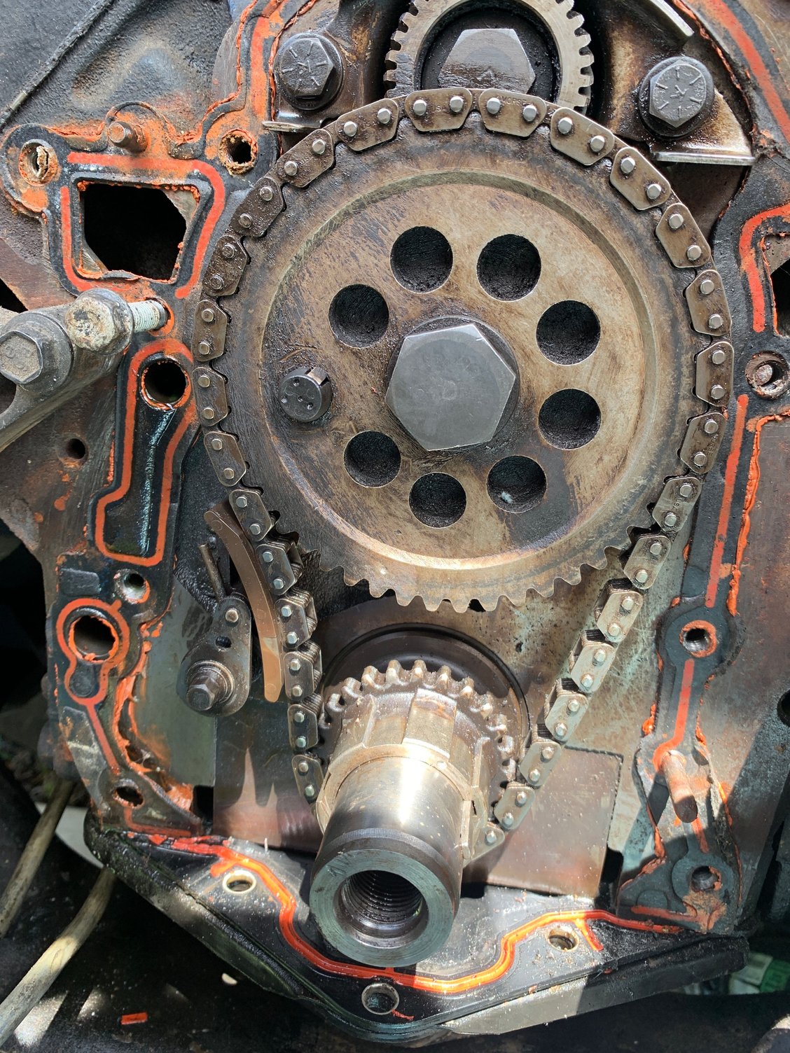

Ok now I’m gonna need some advice/guidance from the experts on this one. What is the best way to measure the slack in the timing chain on a 99 camaro 3.8L? I have a Haynes book it says the “total free play between the sprockets should not exceed 1” “ I’m taking it as remove the retainer and measure both sides for the total! Is that correct?

To Gorn: it’s showing your comment in my email but not on the thread, but when you say all the slack do you mean pull the tensioner as tonight as it will go or do you mean untill there is resistance?
Here is a pic of it if it helps

looks fine to me. at this point I would be looking for a newer series 3 3.8. I found one from a 06 Buick with 60k miles for 400 bucks for my 2000. put new head gaskets and such before installing. figure its good for 200k miles now. here's the thread for the change https://camaroforums.com/forum/93-02...-change-80747/ more info on engine change https://camaroforums.com/forum/93-02...nt-info-57568/

I started a thread but it was too much typing to be complete. The manual will show you the procedure, also check youtube of a how to: check a timing chain. You can also check the inside of the cover for spots it was hitting. It should leave marks.
The counter balance behind the timing chain can also cause a knock but the odds are its a front main or number one rod. Before you put any real money in the engine look up Craby posted.
Pull your dip stick and look under magnification if you see sparkles (metallic flakes) then your engine is hurt.
