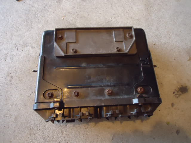

this is the ecm

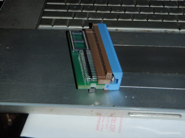

this is the prom with an adapter for tuning hooked to it. if when you open the ecm you see something like it between the prom and ecm then you have a tune of some sort.

Well i took my ECU apart and no I have the blue and brown thing but no additional adapter. That said the actual prom was loose and wiggled freely in its connector. ECU circuit board is good no burnt out spots
