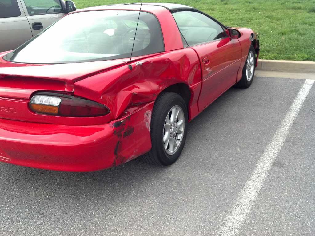

I recently got into a bit of a wreck. My rear quarter panel and bumper were damaged. Bumper easy fix. But as far as the panel goes. what kind of project did I get myself into and how much more might that cost me to get it done professionally

It would help if you had pics of the car. These are not too hard to put a qtr on but they are not the easiest. Depending on how you got hit you may or may not need to have the car on a frame rack and have it pulled back how it should be. Post some pics I can give you a better idea. Oh and I have a few years as a professional bodyman under my belt.

That is not going to be an easy one. By the looks I would say you have structure damage as well as the cosmetic. Getting the car on a frame rack and doing some measurements would be recomended before you cut the qtr off. After that you will be looking at outer wheel well and maybe inner wheel well and trunk flooring that will be damged and will need to be massaged or replaced. It may simply be easier to get a new car unless you have body training. It may be a good project for a local Tech College that has an Autobody class. You would get the work done cheaper than a real body shop but the quality would be just as good since the instructors will be approving each step before the tech can move on to the next step. The ammount of time to get it fixed at a college will be alot longer than a real shop but you would know it is done to industry standards. Good option if you dont have the skills yourself.
