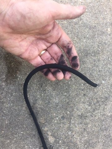

Check all of your vacuum lines. Even after having more than mechanic look at it, I still had idle/rough running during warm up. So I decided to visually inspect them myself. The first one I found was a long one that ran from the canister to underneath the distributor. The thing literally disintegrated in my hand.
The new ones (from Jegs)
