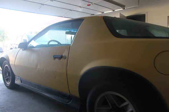

Just picked up this 91 RS for $300. Someone did a poor job at painting it yellow, wish they would have left it the original color, looks like a teal blue. I plan to get it painted back to that color when the time comes. The motor turns over and wants to start, but I don't think it is getting fuel. Gonna check out the fuel pump relay and fuel pump. I also plan to change the oil and flush the radiator and put new coolant in it.
Both front fenders, the hood and front end will have to be replaced. The rest of the body looks to be good.

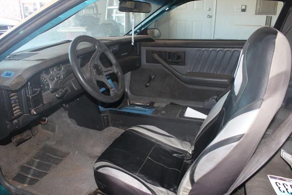

And the interior will need some work, I was told that the gauges didn't work, but so far they seem to work. I am not sure of the speedo, since I haven't been able to start it or drive it yet. I also need to get a new drivers seat. Looks like the old one broke and someone moved the pass seat to the drivers side. The dash will also have to be replaced.

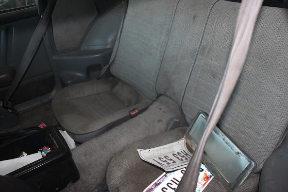

Here are some pics of the interior.

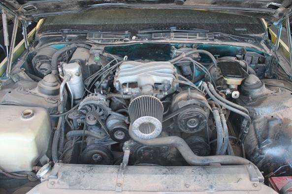

I got the spark plugs, distributor cap and rotor and fuel filter changed out. After all that, I tried to crank her up and fired for about a second. I'm getting spark, but don't think I am getting fuel. I already checked out the fuel pump relay and fuse; both of those were good. I think it is time to check the pump, but I think it will have to be changed. It does not come on when I try to prime the lines. Not looking forward to dropping the fuel tank, but I will if I have to.

Just got done changing out the fuel pump. Dropping the gas tank is pain, but I got it done. Now she fires right up, but I did notice that it is idling high at 3,000 RPM. Guess I get to dig into the MPI and try to figure out what is causing that. Any help on that issue would be greatly appreciated. I also need to fix a transmission leak and change the oil in the rear end and change the O2 sensor since the wire going to it broke off. I still have quite a bit of work to do before I can get her on the road, but so far I have about $400 in it total and I have a Camaro that runs and drives.

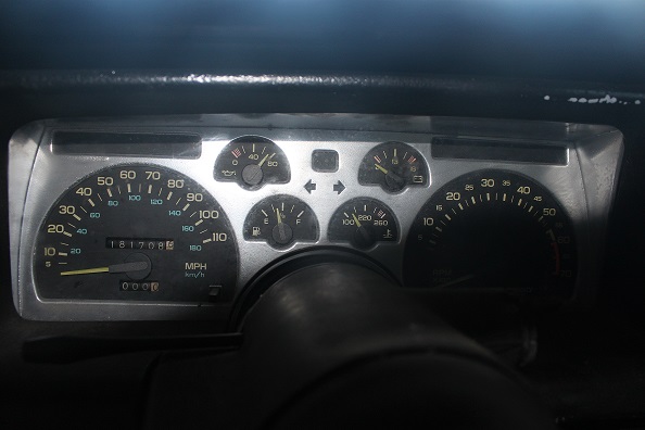

After doing some research on the net, I figured out that the car is not actually idling at 3K RPM, but that the tach is off. Also found a thread over on thirdgen.org that shows how to fix it as well. Guess I need to learn how to solder. Seems to be a very common problem for the 90-92 camaros. Here is a link to the thread if anyone needs it. 90-92 Tachometer fix.... - Page 2 - Third Generation F-Body Message Boards

I took her for a little test drive and she drives great, only one problem-the speedo does not work. I found a thread over on thirdgen.org for a fix and tried that (only cost me about $1.60 for some resistors) but that didn't work. I also tried the tach fix on that site, now my tach is pegged at redline as soon as I start it. I either need to find a cluster out of a 90-92 or get some aftermarket gauges. Sure wish the 91 at the yard still had the gauge cluster in it.

Beginning in 1990, the speedometer is electric, not cable driven as was 1989 and older. And the tach is V6/V8 specific.
Btw, I was chasing the reading double issue with the tach when I had a 91, and bought another cluster. That didn't change the reading at all. Upon further investigating, I found that the ignition module inside the distributor can also be a contributing factor to the misreading tach. I would try the module first before replacing the cluster. As far as the speedo, I would first check make sure it's not the VSS (vehicle speed sensor) on the trans. I still have a 1991 gauge cluster leftover from when I had one, but my tach wouldn't do you any good, I had a 305 V8.

At the moment, I'm not too concerned with the tach, I will tackle that once I can actually drive the car. As for the speedo, I have already changed the VSS and checked all the wiring from it to the speedo, I did find that the chip for the speedo looks like it has some burn marks on it. I plan to get another circuit board for the speedo and install that to see if that will fix it.

My main issue ATM is that the engine surges while driving at low speeds. While looking for vacuum leaks I found that the EGR valve has a broken mount bolt, the EGR adaptor to the exhaust manifold has a broken bolt ( and I broke the other one trying to get it off) and both exhaust manifolds have 2 broken bolts each. I plan to pull the manifolds and replace all the hardware and gaskets. Hope to have it running reliably real soon. Then I can start to plan out the 350 that I would like to drop in it eventually.
