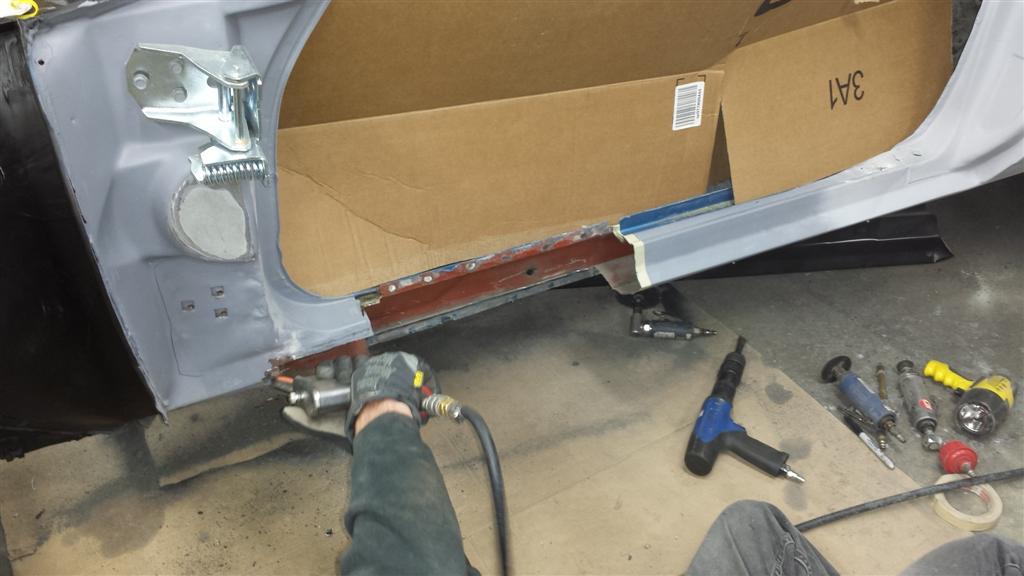

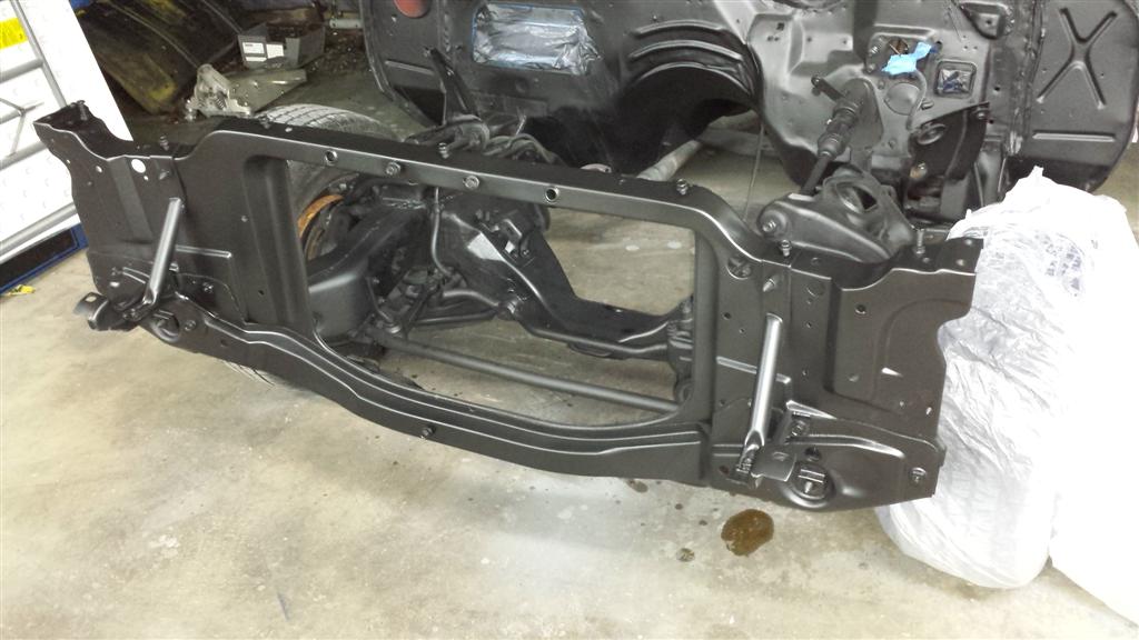

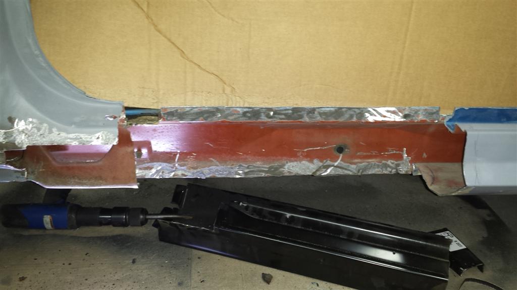

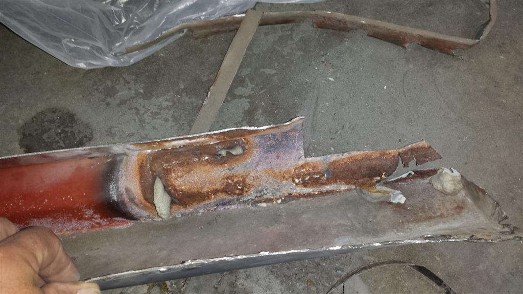

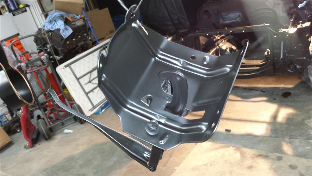

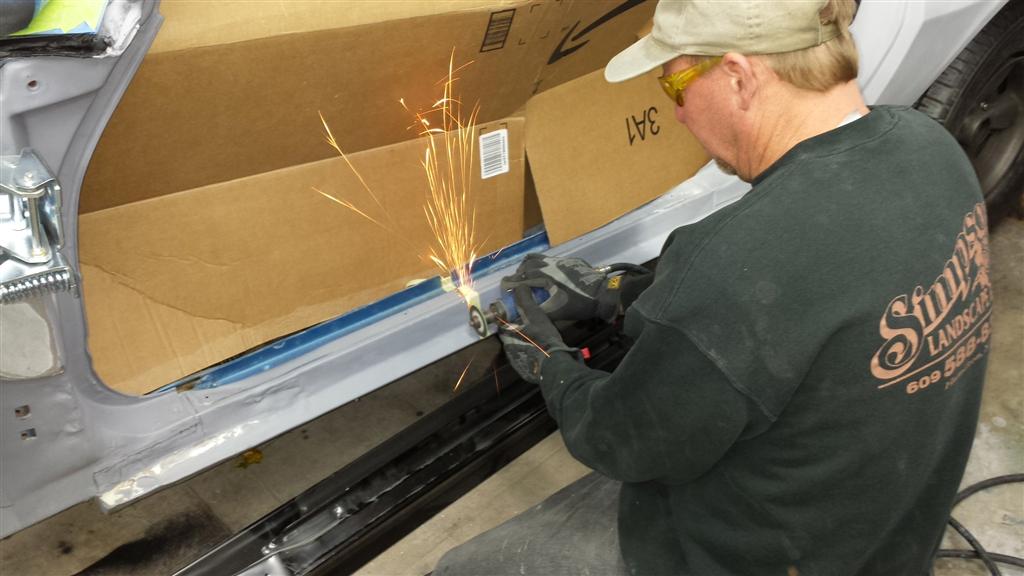

we started working on the rocker panel today. cut the old one out. check out the picture of the bondo that seeped through the cracks in the metal. had to get the persuader out to get the new one to fit (LOL). who ever did the body back in the day never pulled out the body where the door hinges bolt to. so we smacked the inside of the frame with a B.F. sledge and the rocket slid right into place. we have it fit in with sheet metal screws. next i had to put the front end back on so we can line up the rocker, fender and door. got the rad support on the car and painted. painted a few other parts too. everything to do with the engine compartment.

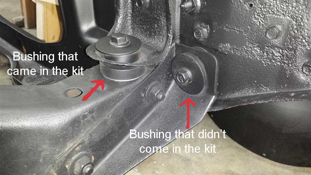

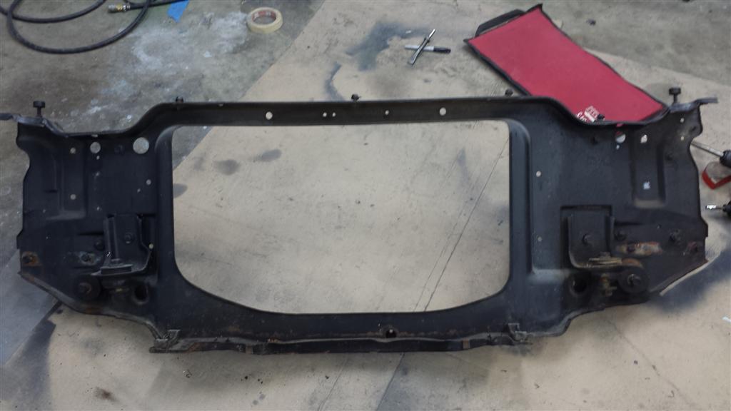

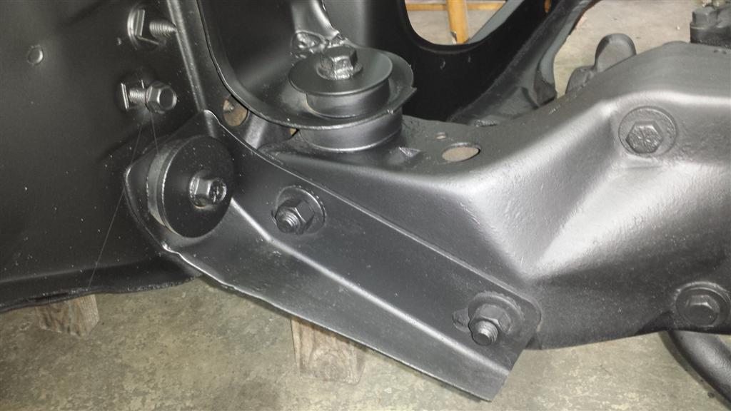

hopefully someone can answer this,
i bought a bushing kit for the radiator support. when i went to put it on, it only contained the the vertical bushings and bolts. there were no bushings for the horizontal bolts. can you get these bushings? am i missing something?

i noticed that i didn't get any response to my question. i called classic industries and asked them about it and they had no clue what i was talking about. so here's some pics. is anyone's car like this?
Old Oct 14, 2014 | 03:33 PM
  #49
meanstrk's Avatar
Posts: 73
That's how mine is. I should check the bushing kit I just got it. It's suppose to have all of them. Which kit did you order?
