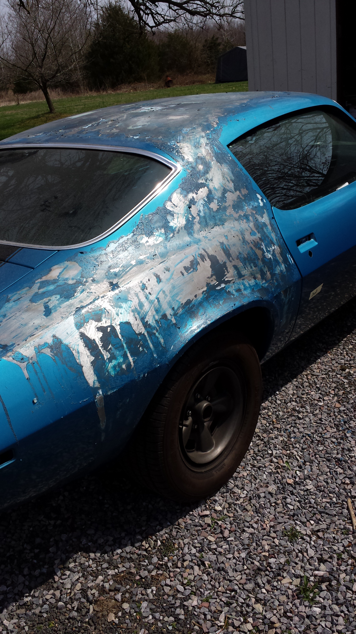

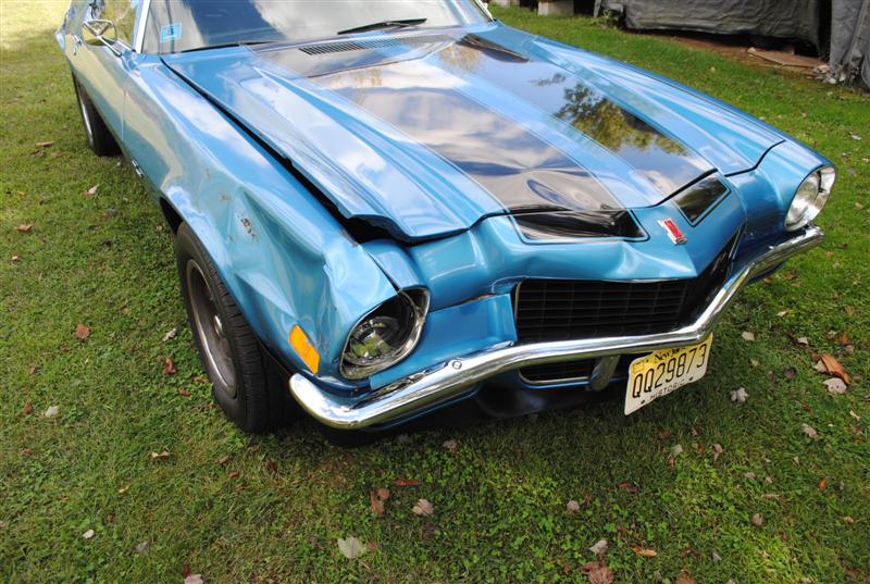

i got thrown into 2 projects at once. in the 1st gen section, i've got a thread on restoring my wife's '68. but an unfortunate incident (accident) with a deer threw us (me) into a complete resto of my wife's Z. the deer took out the front end. the insurance is paying to fix it. here's where it gets complicated. the paint turned into the critical hinging point on which direction to go with the repairs.
here's a little history. we (she) bought the car back in 2001. it was sitting in someone's shop unfinished for 19 years. the body and paint were done but the drivetrain wasn't installed. original motor, non-original auto trans. since the body was restored back in 1980, it was painted with lacquer paint.
here's our problem. the wife's been using the car since 2002, the paint's faded in spots and some body work is starting to show through. the insurance paid to paint 1/2 the car. why not paint the other 1/2, right?

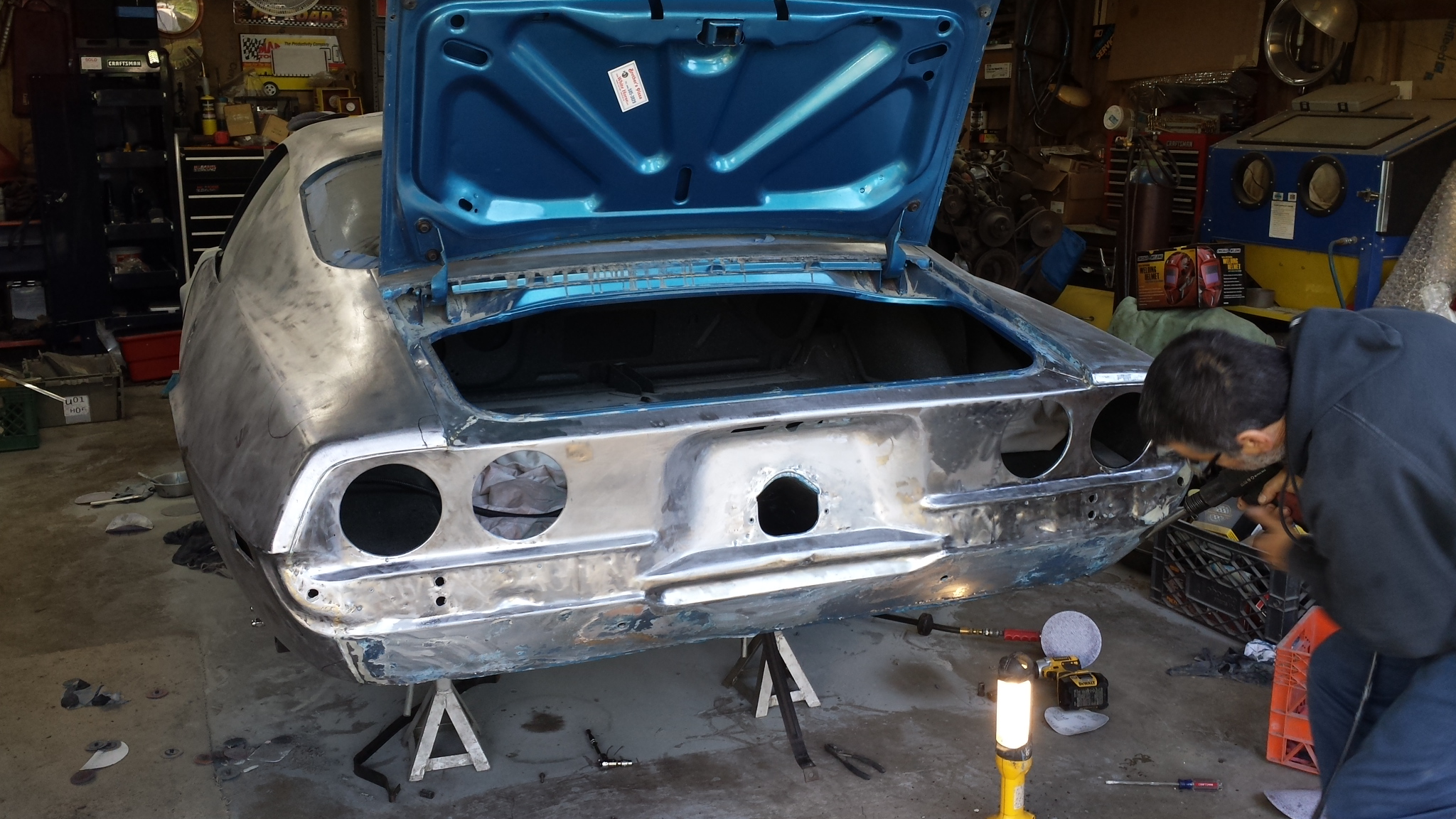

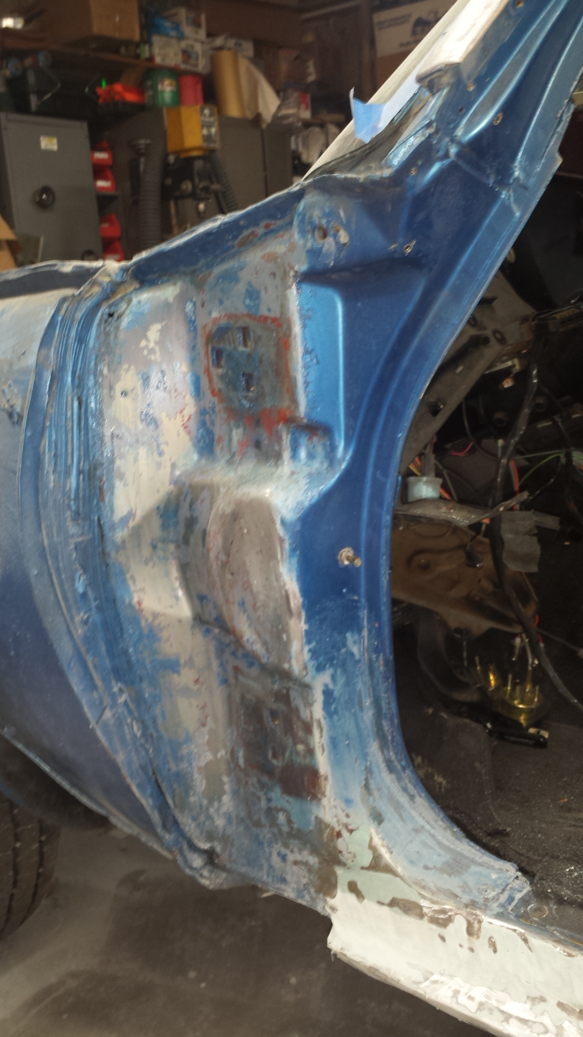

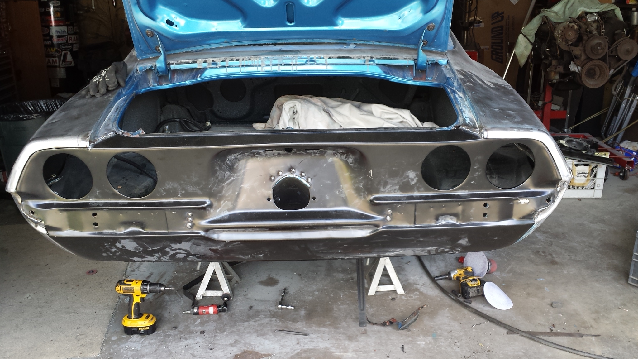

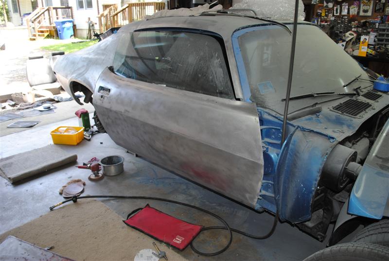

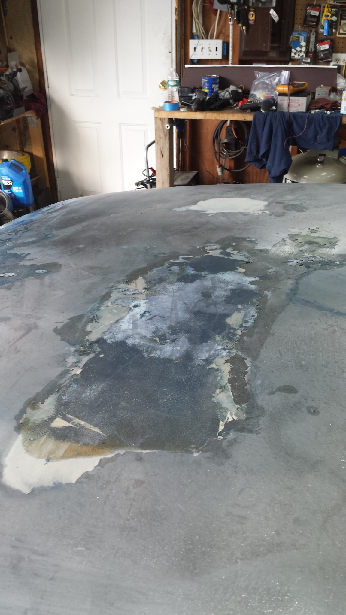

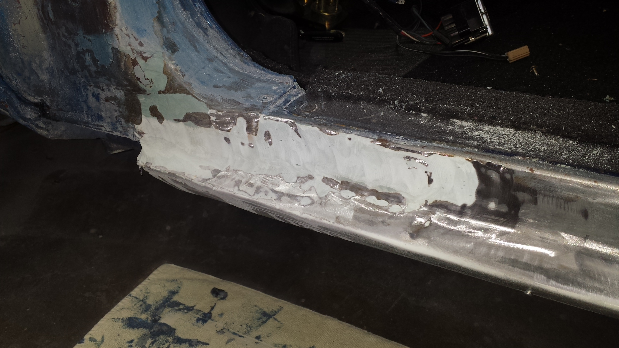

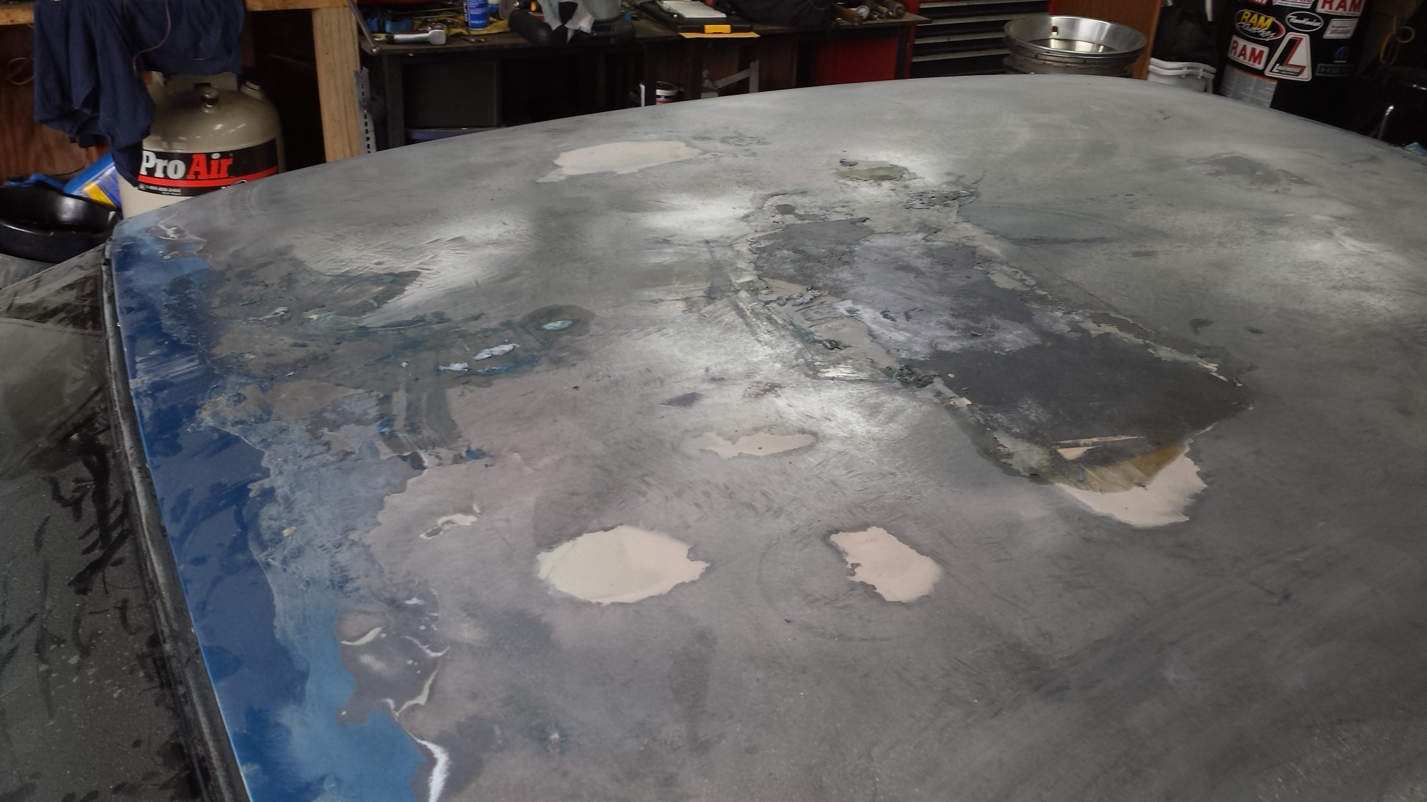

well, to use modern 2 stage paint, all the lacquer has to be stripped off (which is what i wanted to do after i got the '68 done). but the more i strip, the more i'm finding out that this car is not as prefect as we were told. we are replacing the tail panel (already on) and trunk lid cause there was nothing but bondo in there. we found that the drivers 1/4 panel was replaced after sanding. but the real answers showed up last night. there was a bunch of bondo in the drivers rocker. i finally got the door off and started sanding the jam. this car was clobbered on the drivers side. sucks!

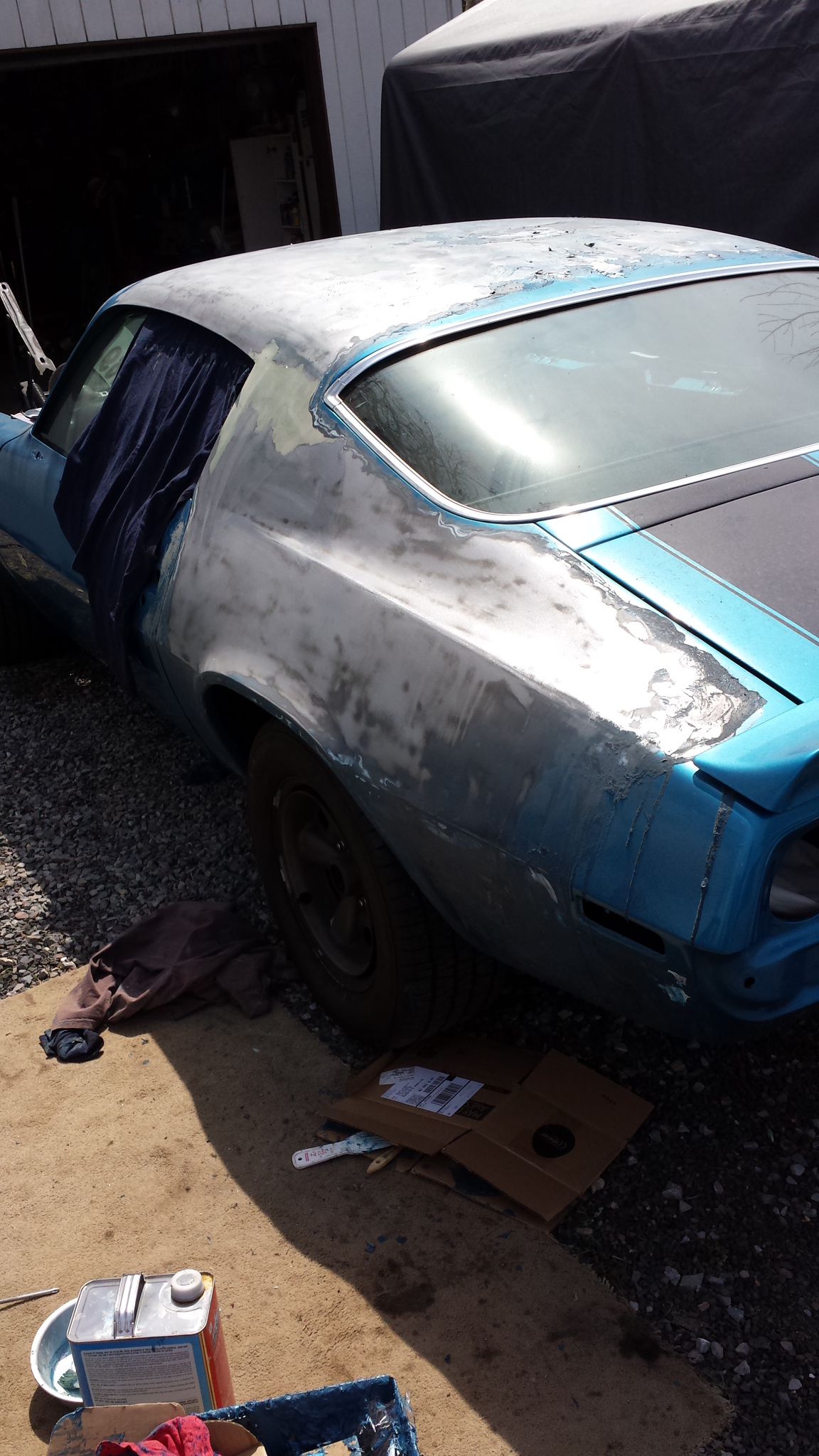

Where's the replacement line on the 1/4???
Old Jun 24, 2014 | 09:49 PM
joelson6's Avatar
Joined: Oct 2013
Posts: 99
From: Pinelands, NJ

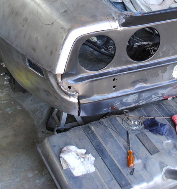

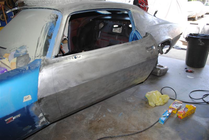

the left 1/4 was brazed in. 2 pics up, ya see that nice hunk of bondo at the roof line, that is one place. the other was in the trunk jamb under the trunk hinge. the 3rd is where the QP meets the body in the door jamb (that is actually pretty nice). the wheel well was pretty botched, they pinched the QP to the outer wheelhouse and made all these little dents that were filled with bondo. where the QP meets the lower valence was pretty bad too. there was a gap, about 1/2" between the two and was filled with braze. then they drew an line in the bondo to make it look like the seam was there (HAHA, pretty bad huh). with the new tail panel on, i have a 1/2" gap between the QP and the valence.
Old Jun 25, 2014 | 09:00 AM
Looks like you'll probably have to split the QP at the edge of that gap, and do a small filler piece to get a "normal" seam there. Seems like replacement panels these days are all a poor fit, regardless of maker.
I would think good factory replacement panels would have been readily available for the car in 1980, as factories carried parts for 20 years. But I think in your car's case it was just a repair shop's decision to cut corners and increase profit. No surprise then or today, regardless of technology. Some things never change, and often it takes guys working on their own cars to make things right.
Old Jun 26, 2014 | 08:52 AM
looks like a full 1/4 for sure. Mine had mud in the sail area from the factory. With what you have though I think some metal work and it will be good to go. The tail seam looks like what Val said, a filler may get ya where you want it. Are you sure its not the aftermarket tail coming up short there? Maybe section it and then put the seam in its right spot and filling the hole left from sectioning?
Old Jun 26, 2014 | 10:14 AM
Since the vertical line on the tail panel looks so straight, I don't think sectioning it and moving it left would look good. That junction should be a pretty straight, vertical line, so whatever needs to be moved to keep it dead vertical will look proper.
