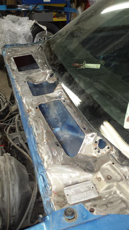

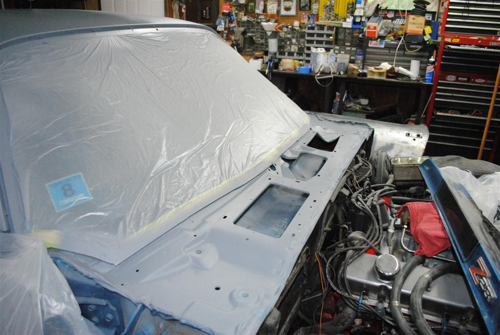

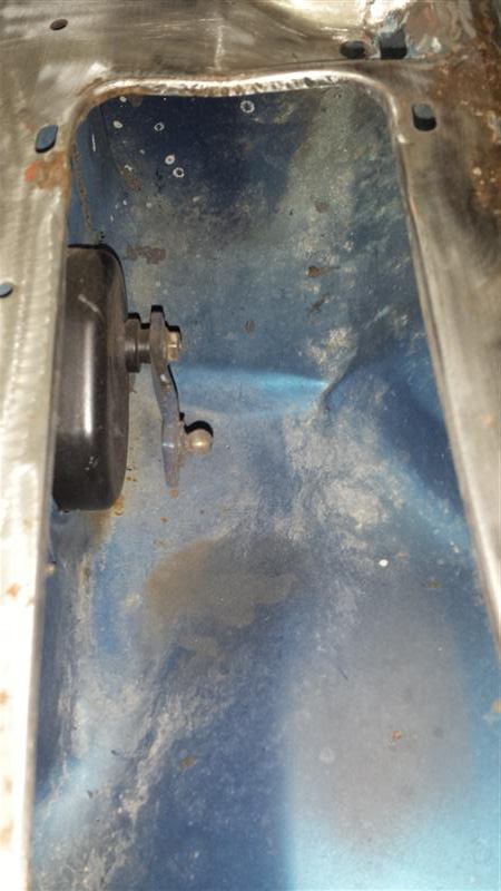

hey guys, havent done much with the car lately, been busy with other stuff. but i gotta get back on it. i stripped out the cowl yesterday. here's some shots
i have some questions about how things were done from the factory on these cars. cause it's a real Z28, i want to get things as close as i can back to looking like factory. please bear with me, i'm still learning all this GM stuff. any info will be greatly appreciated. with the cowl and wiper area, our car was painted body color. i've seen most other cars painted black. which is correct for factory original? once again thanks for all the help!
Old Jul 21, 2014 | 04:30 PM
  #26
Mine is/was black from the factory. My 78 was the same. You have a Norwood car so the color of the floor pans should be red oxide, but the cowls as far as I know are all black and then a cut line at the windshield for the interior color.
Old Jul 22, 2014 | 07:10 AM
  #27
joelson6's Avatar
Joined: Oct 2013
Posts: 99
From: Pinelands, NJ
thanks, the interior is black too so that should be easy. i got the kick panels out and it was all red oxide behind them.
now, what is the closest (to factory) brand for the black on the cowl? i'm guessing it was semi gloss. i use a lot of easewood's stuff. been happy with it so far.

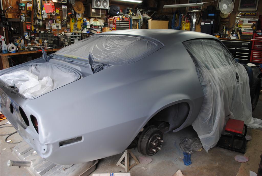

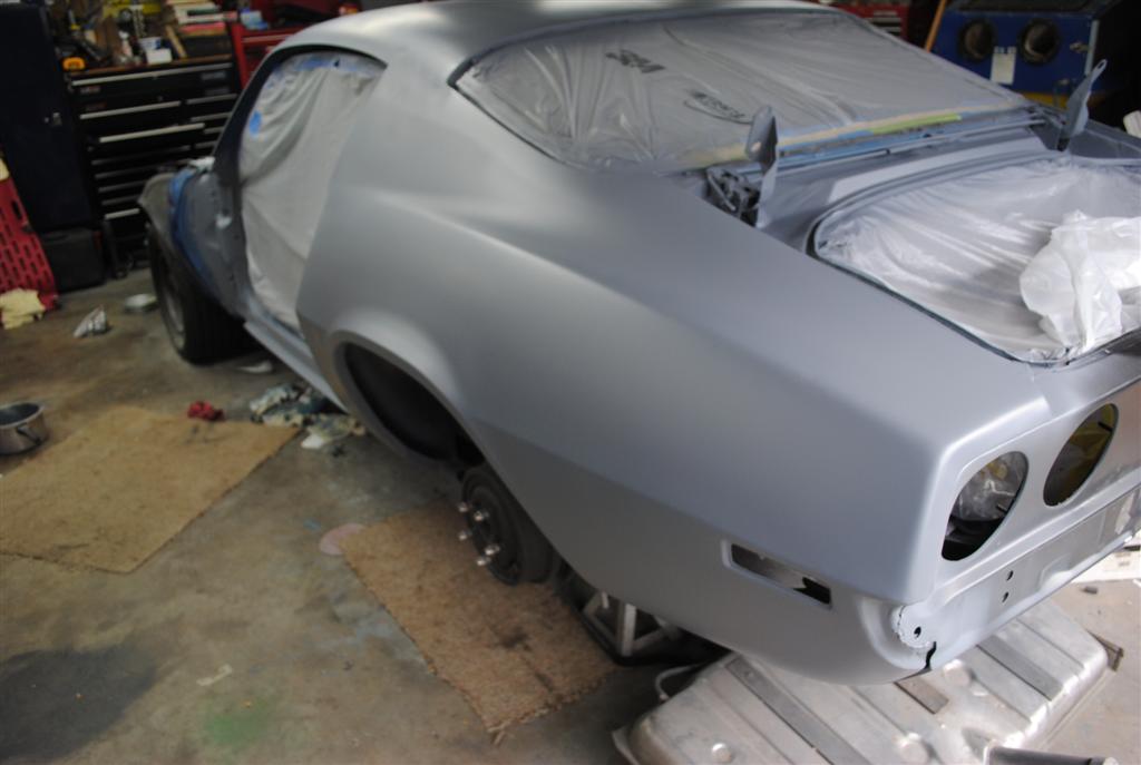

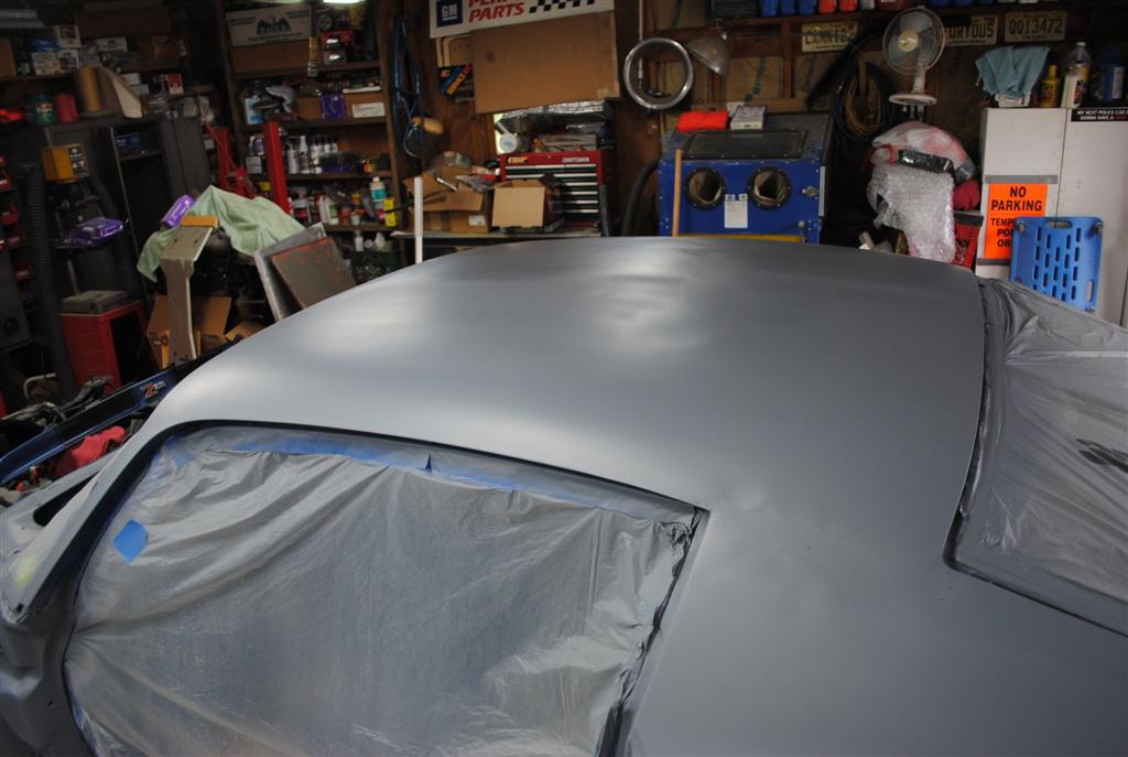

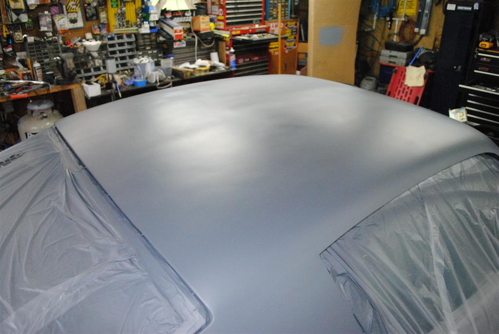

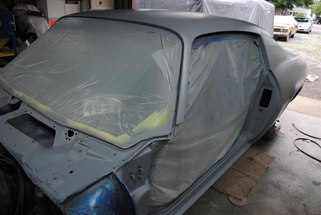

got the car in primer today,well most of it
Old Aug 4, 2014 | 09:04 AM
  #29
Looks great! You're really moving along on it!
Old Aug 5, 2014 | 11:41 AM
  #30
joelson6's Avatar
Joined: Oct 2013
Posts: 99
From: Pinelands, NJ
thanks, not as fast as i'd like but it's getting there
