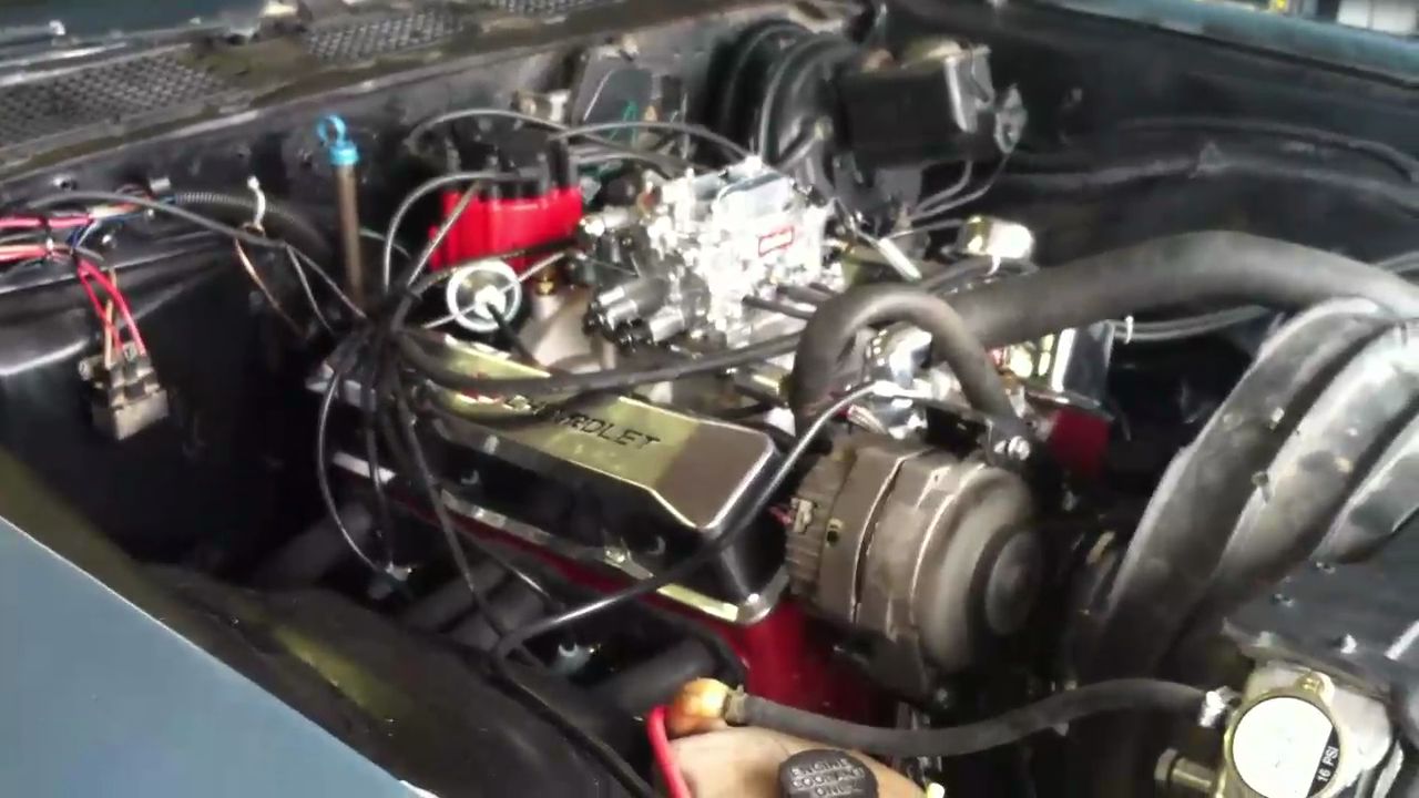

Started the motor On sat. Primed it and then had a heck of a time getting the dist loc back in place. But motor fired right up so I checked a couple of things and then brought it up to 2500 for 20 min. Oil pressure was good and leveled off at 60lbs. And temp was good at 180. Here is a clip if it works. some back ground noise is echo in shop. had one little noise at end of break in,thinks its just a rocker out of adjustment.

Had to double click on pic to get video to play not sure why. hope it works for everyone else. Next will be reajusting rockers and getting timing set and card ajusted. Hoping for a warmer day so I can have shop open and heaters not on.
