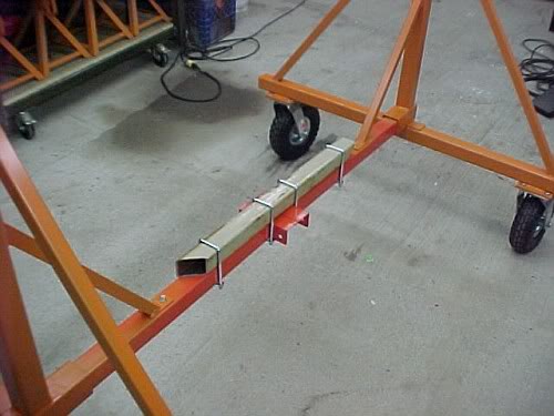

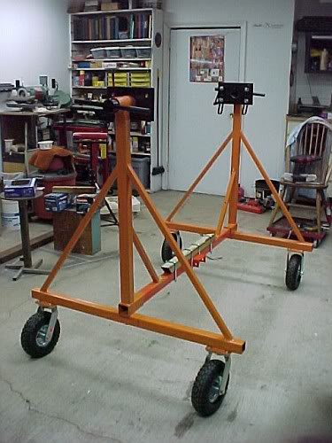

I think it's an excellent welder to build just about anything, but I'd never use engine stands as a base for a rotisserie! They don't have a wide enough footprint to stabilize something as large as a car body and ensure your safety while your working. Now if you plan to cut up engine stands and make wider bases and just use the uprights as pivot points, then that might work if properly built. But then you'd be out an engine stand, and at the cost of stands it's cheaper to build from scratch.
i was thinking something like this but with big square tubing on the pivots to bolt the body to.
Maybe a bit more sturdy, and i don't know about those wheels
Something along these lines anyway
and it would have to be stronger here
Old Apr 9, 2010 | 06:48 PM

Need a lot of room to roll it around on tires, and there's always the possibility it might slip in the makeshift process and bend something. Just doesn't make me feel all warm and fuzzy.
That one pictured looks pretty sturdy, but as you say it needs some longer frame to bolt to firewall and tail. It also needs to be a lot farther apart! Doesn't look like you could get anything much longer than a go kart between those pivot points!
