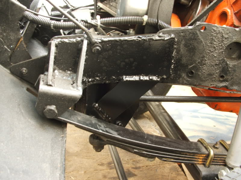

Did some upgrades to the Austin today. Some athetics, and some for strength. I was under the car yesterday checking everything to determine the vibration I was feeling at 55 mph, and while working the steering wheel I noticdd the mounting plate for the Corvair box had some minor deflection. Nothing serious, but still bugged me, so I welded another gusset to the opposite side of the plate. Thought I had plenty, but I guess there was room for more, so in it went. Just an angled brace to strengthen it further:

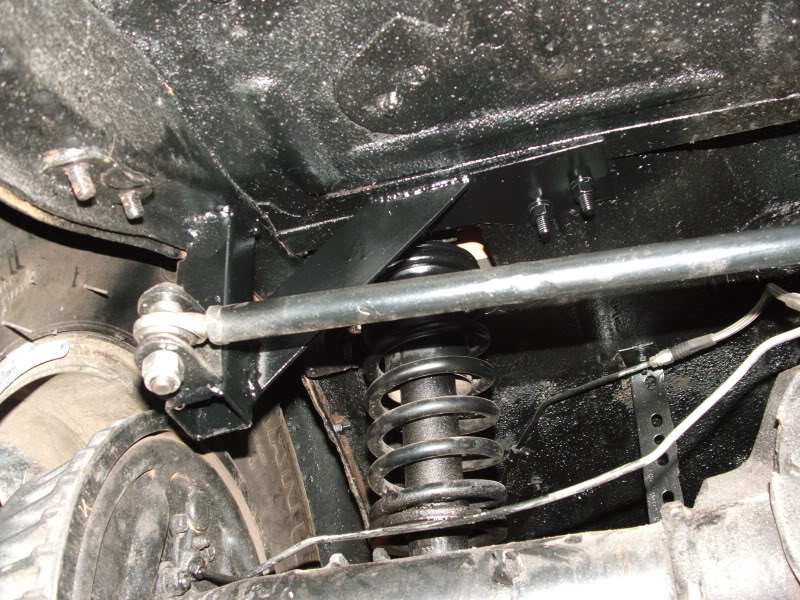

In the back the mount I put in for the panhard bar's frame end didn't move, but as long as I was welding I decided to give it an angled brace to the floor, and a welded plate on the bottom, then a plate inside to sandwich the floor and further strengthen things back there too:

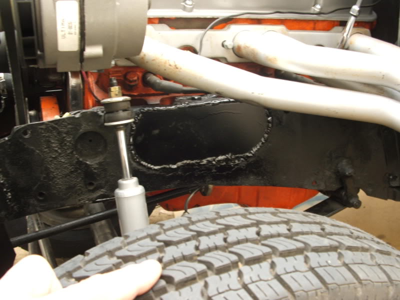

The asthetics were the oval factory holes in the frame used to lighten the car. I had welded braces across the holes with plans to weld them shut afterwards, just never got around to it, so:

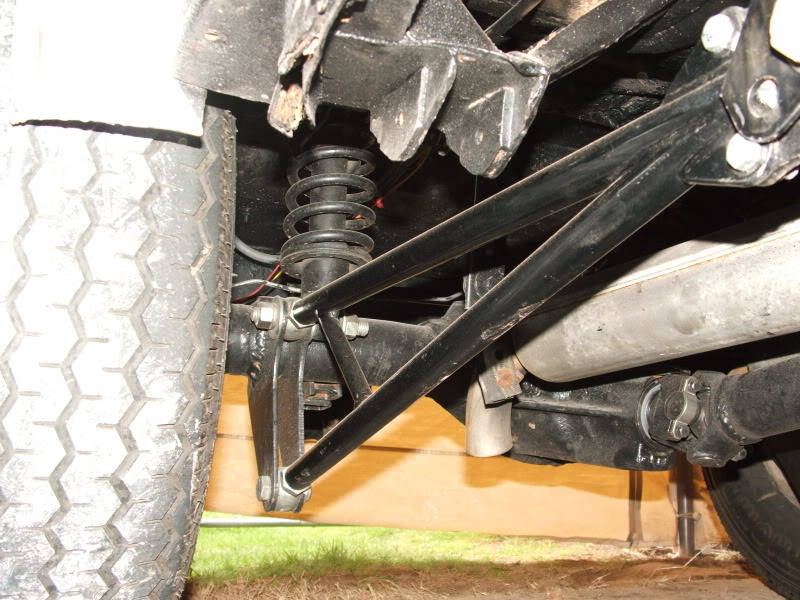

Still have to get the sawzall out one of these days and hack these old leaf spring perches off, but I've done enough today:
