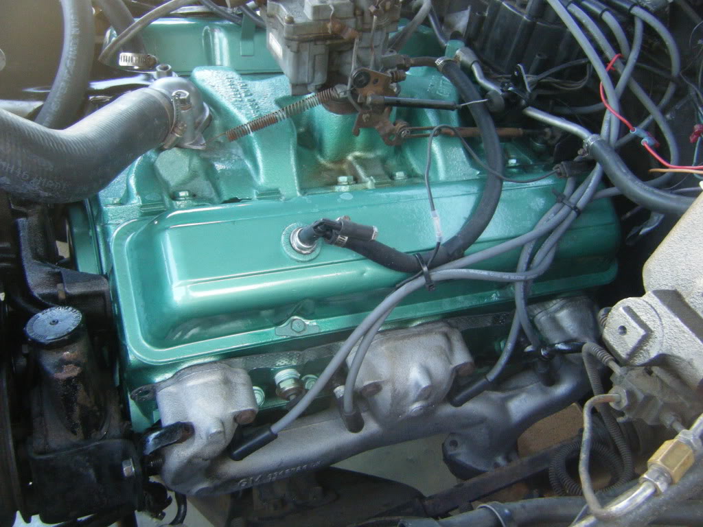

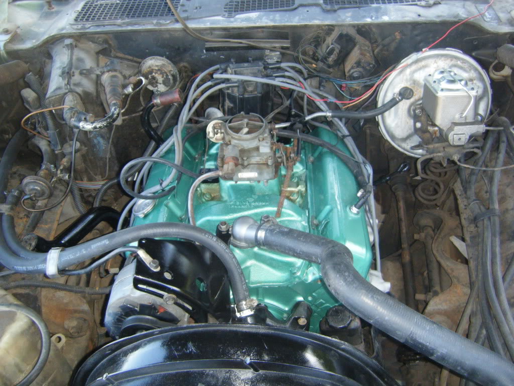

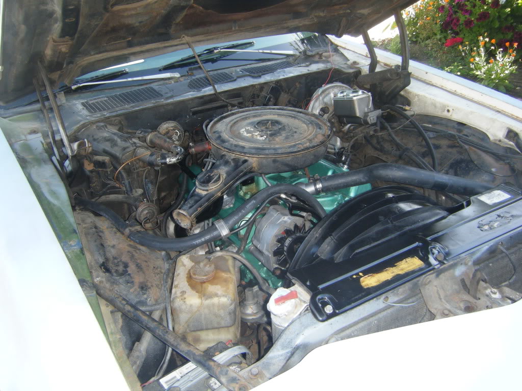

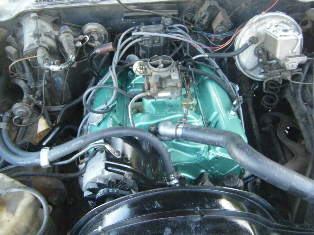

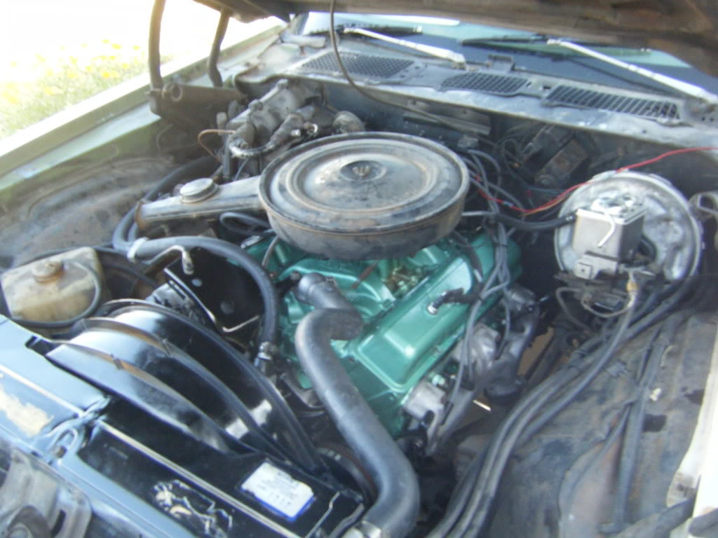

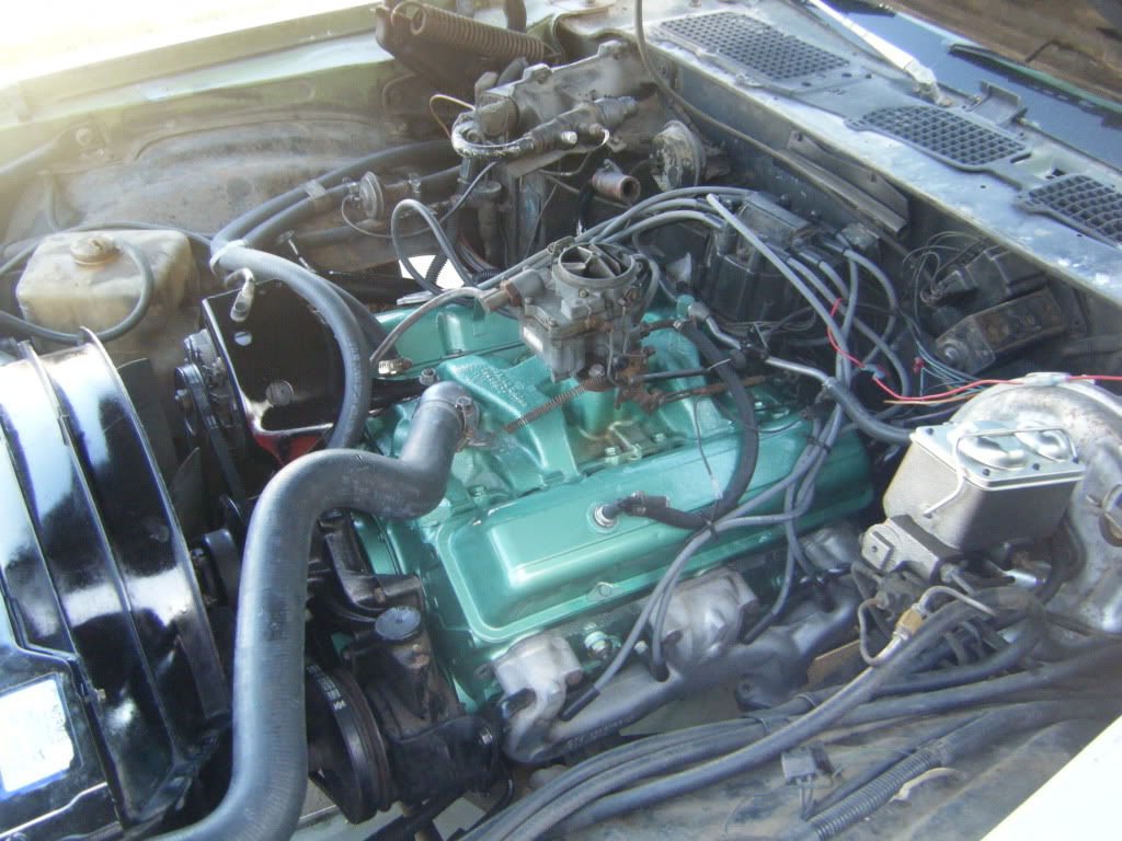

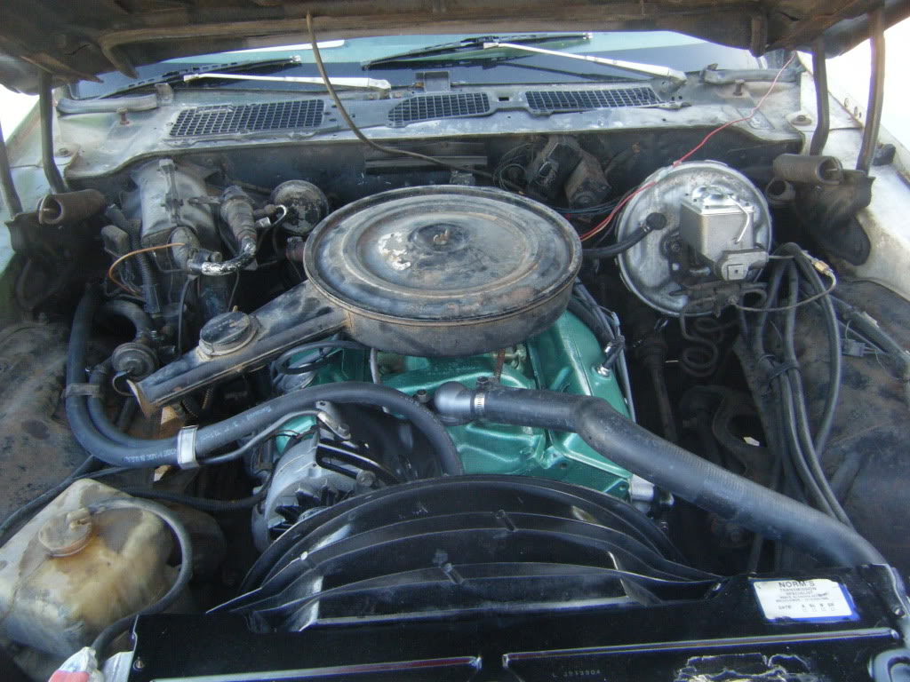

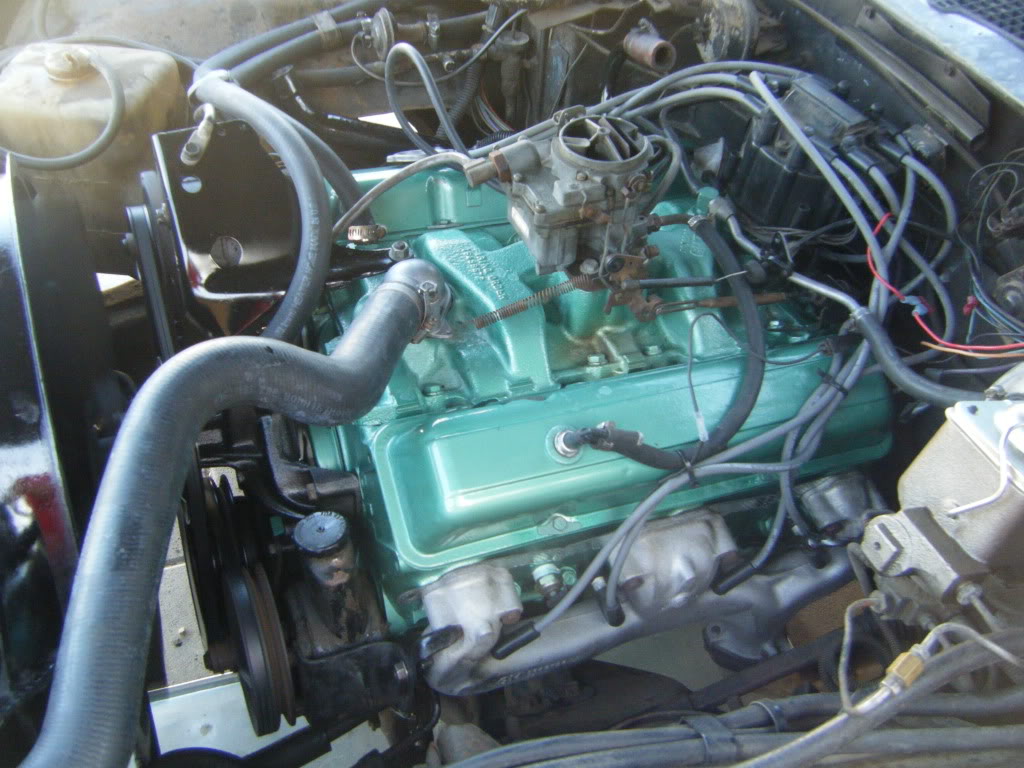

ok guys got my car from the shop. it runs very good . but now i don't know what they did but my brakes feel funny it feels like my brake booster, doesn't work. the pedal feels real hard. will that happen todo with anything from the new motor or cam, it feels like it dose not have air. oh here are some pictures don't mind the air cleaner i was happy i found the o.g. one. i will have to cleaning and paint it.

Cam doesn't sound radical enough to have any vacuum issues. You should have plenty of vacuum with it. I'd question if there may be a vacuum leak or a bad booster( was it new with the new brakes?).
You might want to call the folks who rebuilt it and tell them about the brake issue and see if they might check to see if there are any leaks.
Agreed... if it's a 270 duration cam I don't think you should be seeing any problems with the brakes not having enough vacuum. My 280h cam had plenty of vacuum for braking. When you're coasting to a stop your engine vacuum usually climbs well above what it has at idle.
