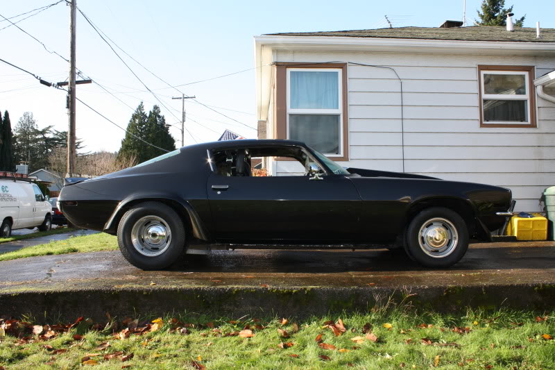

Never drug the slapper bars and they hung slightly lower. Speed bumps aren't like curbs so the angle being gradual allows thw tire to bring the car up before the bar can hit. I wont be going 4 wheelin though!
That is the old slapper bar bracket, so that shows you how low the bars were. This was the rear bracket and the front was angled down and the bar was 2" thick, plus the snubber that was another 2", with 1" clearance. Those babies really hung down! My driveway is steeper than a speed bump and they clear it!
Take a look at the slappers in this picture:
