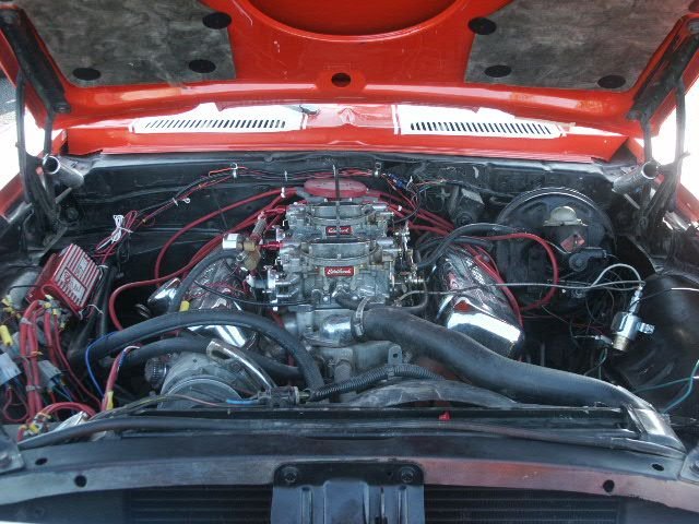

Before I do what's described below, could going to a high volume/pressure pump resolve this issue?
My 69 has a 454/T400 in it that needs some work... when hot, it's got low to no oil pressure showing on my mechanical gauge (which I replaced to make sure)
454 in my 69...
... even at 60 (2600 rpm) it's always no more than 17PSI or so, though it shows around 60 at start up... a looks like bearings (cam and main)... rear main seal... switch to hydraulic lifters... hp oil pump...
That's not going to happen until next year... so, in the interim, I've got a stroker I can swap into it.
My guess is that it would need mounts, headers/exhaust system. When it comes to the trans, can I go with the flexplate on the 454? Do I need another torque converter?
Is there anything else I'm overlooking?
